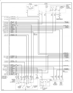

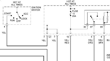

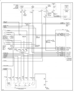

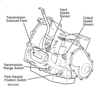

Fuse box than ignition switch
https://www.2carpros.com/forum/automotive_pictures/99387_Graphic1_298.jpg
https://www.2carpros.com/forum/automotive_pictures/99387_Untitledtt_1.jpg
Friday, August 18th, 2017 AT 8:18 PM

BOBSCNC
  • 10 POSTS
Here it is 4 PM central time In wisconsin.
I was tracking the yellow Wir with out much success.
I studied the schematics again and came to some conclusions.
Not trying to start a disagreement but here are some of my thoughts / questions.
I am useing Mitchel schematics from Eautorepair. Com which apears to be the ones you use.
Looking a t schematic POWER DISTRIBUTION CIRCUIT (2OF 3) from mitchel,
and doing a test of the ignition switch
The Yellow wire is only hot (energized) when the switch is in the 'START' position. The pink/white wire is hot in the run position.
Some of the schematics show a connection between the run and start connection but I think that is only there with the key in the start position and not in the run position.
Are we sure that we want to be chasing the yellow wire.
I have the front tire and splash panel back on If the eweather is nice I whill pull it back off andt check the yellow and the pink and white.
Have a good easter and will catch you later.
Bob
