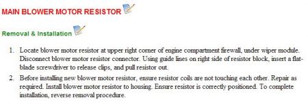

I have removed the glove box as educated by others
and I have purchased the blower resistor but cant find where it goes, is there a housing that needs removal?

Caravan or Grand Caravan? Caravan main blower resistor replacement steps are below....
https://images.2carpros.com/forum/automotive_pictures/261618_Noname_1616.jpg

This was great info....no others were able to point me in the proper direction Thank you ...van fixed and family now warm!
