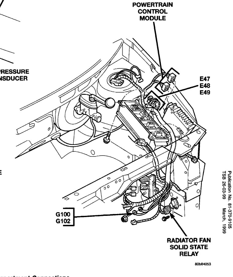

I have determined that the radiator fans are inoperative due to failure of the radiator fans relay. I cannot locate the radiator fans relay under the hood. The radiator fans 40A fuse is located in the fuse/relay box above and to the right of the battery. Where is the radiator fans relay located?

There is not a relay this system uses a controller which is up by the fans on the drivers side. Here is the location in the diagrams below. Check out the diagrams (below). Please let us know if you need anything else to get the problem fixed.

It worked perfect! I got the part and it took me about twenty minutes to install. All fixed!

Radiator coolant fan relay is located on front bumper reinforcement behind the grille.

On my 1997 the relay is near the strut mount on the driver side. Remove the air filter boxes and it is under them to the side. I hope this helps. It took me awhile to find it when mine failed.

The radiator fan relay its at front left frame rail. See below.

There is an electronic relay on the left front frame rail. It is a common failure.
