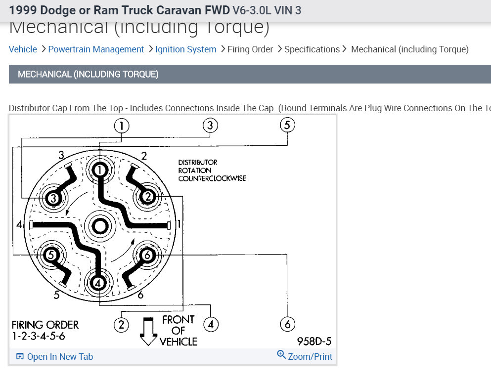

My van does not have any fire going to the ignition coil and it hesitated as it was out of fuel before it shut off now it won't start at all. We have checked all the fuses and we have checked the spark plug to check to see if it was firing and used a test light on the plug wire for power that unplugs from the coil. We replaced the coil now I need the firing order.
Saturday, November 15th, 2008 AT 7:45 PM
14 Replies
JNOVACK
  • 723 POSTS
The coil pack gets its signal from the power control module (pcm) that gets its signal from the camshaft position sensor and the crankshaft position sensor I would look into checking those sensors if not replace them and if you still don't have spark then you should be able to remove a cover on top of engine were the camshafts are located turn engine over and see if the cams are moving if they are then the pcm needs to be tested. Here is the firing order below. Check out the diagrams (Below). Please let us know what happens.

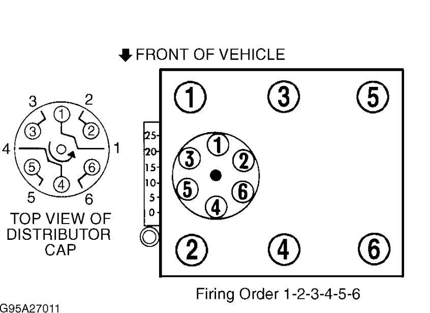

My van come up with a code for misfire at #4 cylinder. I just replaced the spark plugs about 1000 miles ago. Could it be a bad plug or probaly the wires? Which hole is the #4 cylinder?
Thanks,
MIke
+1
Sunday, April 26th, 2020 AT 12:49 PM (Merged)
MHPAUTOS
  • 31,938 POSTS
Hi there, see pic for firing order 3 litre engine.

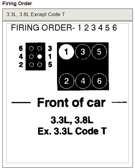

#5 fuel injector is stopped up how do I fix it. Do you have a firing order diagram for 3.3 v6 dodge caravan.
Friday, June 19th, 2020 AT 1:09 PM (Merged)
MHPAUTOS
  • 31,938 POSTS
The Injector can be bench tested and cleaned or it can be done on car as well, it car is hooked up to a special fuel system cleaner, if done off car all injectors should be cleaned and flow tested. You can also replace it if you wish, see pic for firing order.
