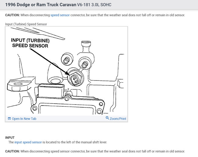

I have a dodge Grand caravan with a v6 3.3l. My transmission get stuck in limp mode (2nd gear)and after 10 minute of driving when the engine and the tranny get warm, I turn off the engine and turn it on and the problem is gone. I did the check engine test and I had codes 12 and 55 which is normal I believe. I disconnected the battery to do a reset and I also tried to turn the key on and of 4 times and it doesn't work. Its stuck in limp mode only when the tranny and the engine is cold. Transmission fluid have been replaced 5 months ago (ATF+3) and looks good.
My fuses looks all right and also the wires so I think I should go to the dealership to get the actual ¨P codes ¨ or should I just change the speed sensors (in and out) and see if that work.
Someone can help me on that?

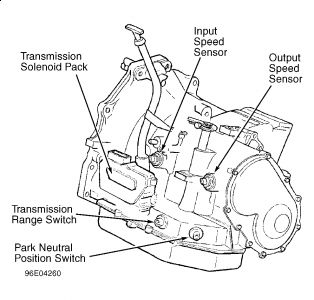

Yes I would do the input shaft sensor first that is what usually goes out. Here is the location and instructions on how to change it. Check out the diagrams (Below). Please let us know what happens.

Where on the tranny are the input and output sensors located on the tranny. It's locked in limp mode and the speedometer quit. Thanks

Both input and output speedsensors are located on the left side of the transaxle. The input speed sensor senses the turbine input by torque converter revolutions(slots on converter housing). The output sensor is mounted in-line behind the input sensor and senses the output shaft by the rear planetary carrier gear tabs. The same gear tabs are used to apply the park pawl, and thus lock the output shaft, preventing movement of the vehicle.
If you open the hood, the are located midway in-line on thr trans. One has course threads and the other has fine threads so they can't be mixed up. Same size wrench is used. Watch for bad connectors on these sensors.

The input sensor is just below the cooler lines on the transmission to sense the spinning input clutch retainer thus sensing the input shaft. 12 inches back is the output sensor. Ok I am tired.

https://www.2carpros.com/forum/automotive_pictures/99387_Graphic9_33.jpg
Check tranny fluid and make sure it full and clean
need to check for tranny codes
suspect speed sensor and or tranny solenoid pack
good luck
