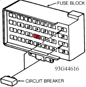

All of my instrument cluster guages ( tach, speeedometer, oil pressure, temp, amps, fuel tank)stopped working. They were working a month or so ago. I removed the battery cables a few weeks ago to recharge the battery. When I replaced the cables, I noticed that the guages were not working. I think they were before but I am not positive. The instrument cluster fuse is the same as the horn. The horn works. Is there any way to test the cluster without removing it and re[lacing it? Could the problem be something other than a bad cluster?
Also, my fan does not turn on, but I believe it will do this only if engine needs cooling?

Your horn is not controlled by the same fuse. Re-check fuse #15 (high-lighted).
http://www.2carpros.com/forum/automotive_pictures/55316_94caravanfuse1_1.jpg
FUSE IDENTIFICATION
1 15A Fog Lights
2 15A Park Lamps, Fog Lamp Module
3 20A Cigar Lighter, Horn Relay, Horn, Speaker Amp
4 Not Used
5 20A Front Wiper, Front Washer
6 10A Radio
7 20A Power Vents, Mini Trip Computer
8 10A Heated Mirrors
9 5A Indicator Light, Rear AC
10 20A Power Door Locks
11 15A Stop Lamps, ABS Controller
12 20A Rear Blower
13 20A Rear Window Wiper/Washer, Airbag
14 2A Speed Control
15 10A Warning Lights, Cluster, Body Controller, Remote Keyless Entry
16 10A ABS Controller, Engine Controller, Fuel Pump Relay, Transmission Controller, Auto Shutdown Relay, Radiator Fan Relay, Back-up Lamp Relay, AC Clutch Relay
17 10A Left Low Beam Headlamp
18 10A Right Low Beam headlamp
19 10A Turn Signals, Combo Flasher
20 10A Airbag, Back-up Lamp Relay, Heated Rear Window Relay, Engine Controller, Rear AC Relay, 4WD Solenoid, Rear Wiper Feed, Daylight Running Lamps
21 Not Used
22 Not Used
23 Not Used
24 Not Used
25 Not Used
26 30A Blower Relay
27 Liftgate Release
28 Not Used
