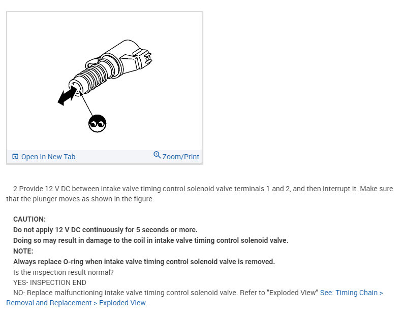

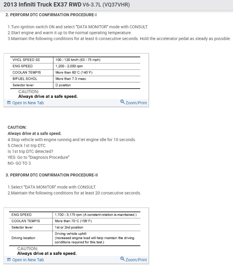

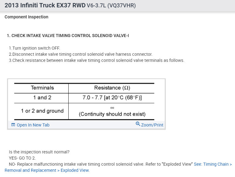

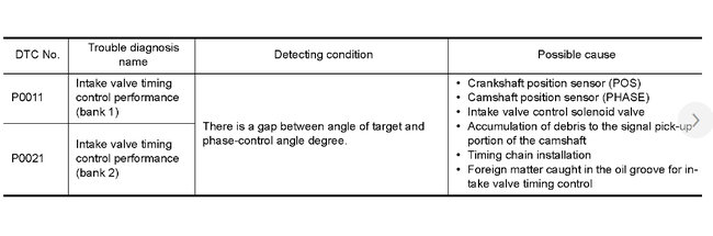

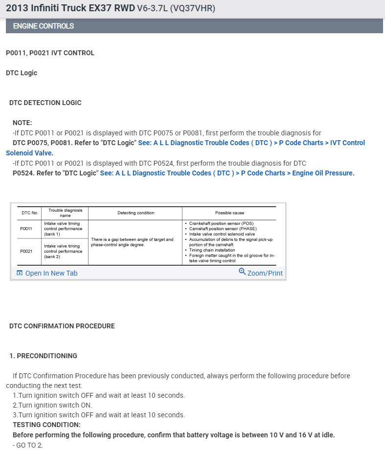

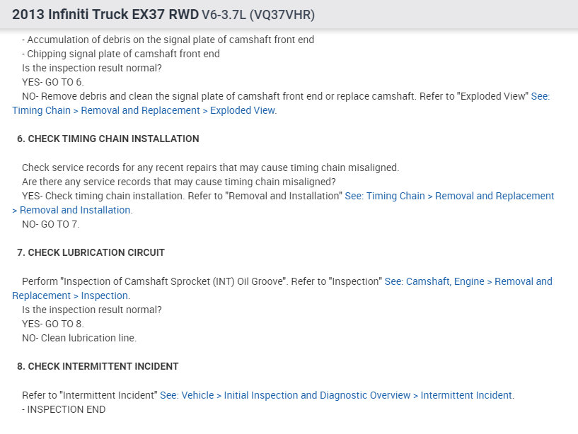

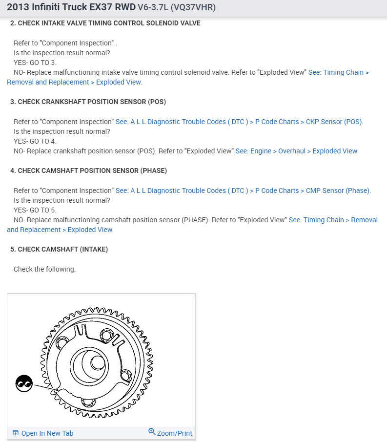

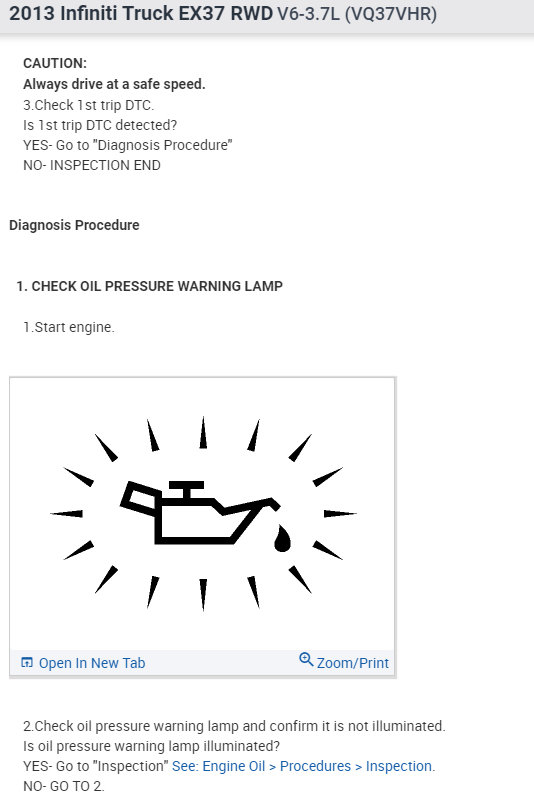

The code P0011 can get triggered for a number of reasons.
It could be due to faulty crank or camshaft position sensor, Intake control solenoid valve. It can also get triggered due to debris being stuck on the signal pickup portion of the camshaft.
The best course of action would be to take a look at the different components to determine the fault.
I have attached below the diagnostic steps for this code.
Follow those steps and it should help you isolate the issue.
Please let me know what you find or if you have any questions.
