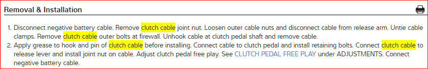

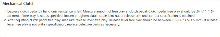

Clutch pedal goes to the floor after replacing clutch
1995 SUZUKI SIDEKICK
160,000 MILES • 1.8L • 4 CYL • 4WD • MANUAL
FIZERMAGIC
I replaced my cars clutch, so I dropped the transmission and reinstalled that.
The only item I have left is reinstalling the clutch cable which I cannot seem to figure out. No matter what I try the pedal still drops to the floor.
Nov 23, 2018 at 11:12 AM
DANNY L
  • CAR REPAIR CONTRIBUTOR
  • 5,648 POSTS
Hello, I am Danny,
I have attached two pictures showing how to change the cable and how to adjust the pedal free play. Hope this helps and feel free to ask any questions. Thanks for using 2CarPros.
