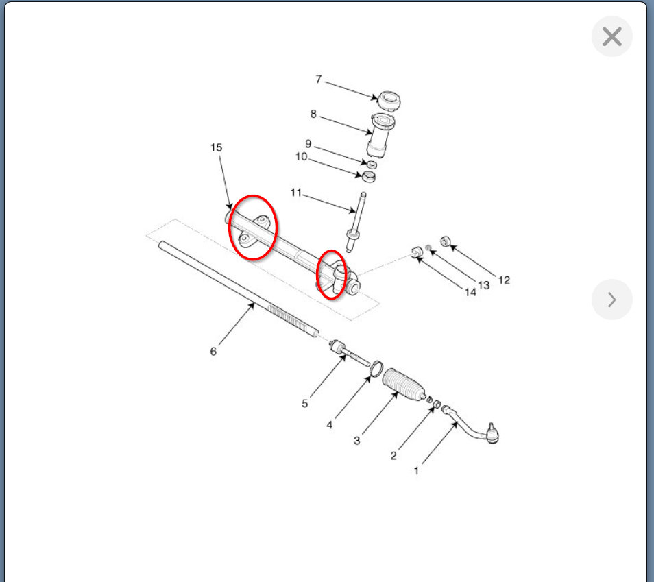

Lastly, we need to check the mounts for the steering gear (rack and pinion) because if this is loose then that will cause the issues.
Darting and jerking on the highway are normally always caused by a loose component but the popping points to suspension. However, the fact that it does it in turns could also be steering so if the rack is moving at all when turning the wheel back and forth when sitting still then that is the issue. You should be able to turn the wheels while not moving and the rack should not move at all. Only the tie rods on the sides of the body of the rack.
