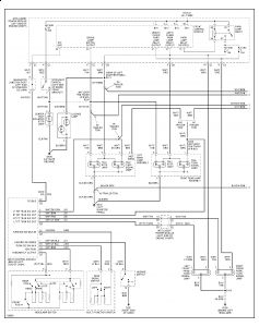

When I put my turn signal on my gauges go crazy and my instrument cluster lights up like a Christmas tree. When I turn the turn signal off they go back to normal. I've already attempted placing a new instrument cluster with the same results. What esle can be causing this?
Saturday, September 26th, 2020 AT 2:28 PM (Merged)
  • 108,133 POSTS
Have you had the body control module checked? Here is a video that will show you how. Also it sounds like a bad ground.
https://youtu.be/InIlnsjOVFA
ALXNALX
  • 6 POSTS
No I have not. I've sinced replaced the multifunction switch for the turn signals and now the gauges seem to work until I tru to activate the turn signal and the gauges go blank and they return to normal when I take off the turn signal. We did notice that the drivers side tail light has a used not factory wiring harness spliced to the original wires from the car which was done at a body shop because of a rear crash. When we studied the wires there is one that was not connected to any other wire. There are 6 wires coming from inside the vechile but only 5 were connected to another wire and according to my Haynes manual there is a 6th wire on the driver side because it shoots over to the passanger tail light. I am assuming this is causing a short but I am in need of a wiring diagram with the color codes for each wire. The used plug's wire they spliced does are not the same colors as the wires coming from inside the vehicle, which are normally white with a color stripe.
  • 108,133 POSTS
Here is a guide to help you with the testing and the cluster wiring diagrams below.
Check out the diagrams (Below). Please let us know what you find. We are interested to see what it is.
ALXNALX
  • 6 POSTS
Whenever I place the turn signal to the right, left and even the emergency flashers the gauges go blank. It seems the blank instrument cluster happens everytime the blinkers are placed. On both the tail lights the brakes, lights and reverse lights work just fine.

So you don't think that the loose wire in the tail light has nothing to do with it? The problems started hapenning after the crash in the rear and the replacement of the light. They spliced together an old pigtail and left one wire out. Since I replaced the multifunction switch for the turnd signals and the wipers everything works fine with the gauges they only stop working when I put the turn signals. It has been 2 days now and the gauges are fine because we have not put the turn signals on.
How do I check if the BCM is faulty?
  • 108,133 POSTS
The wire that isn't connected. Does it have any power to it?
ALXNALX
  • 6 POSTS
Yes it does but I found a bad ground (G201) on the right side of dash all fixed!
+1
  • 108,133 POSTS
Glad you could get it fixed, that kind of problem can be tough. Please use 2CarPros anytime we are here to help.
