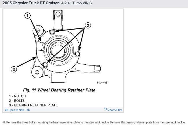

Front drive axles make loud humming noise when driving. The faster the speed the louder the noise. Is this from a worn out wheel bearing? Does not sound like grinding metal just loud tire noise.

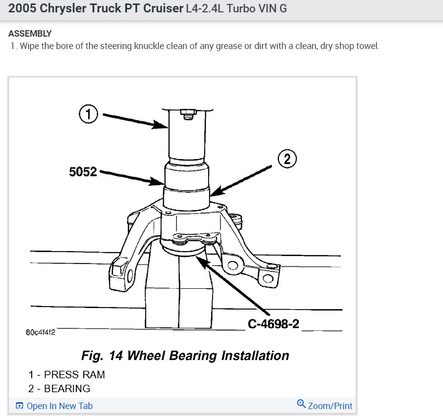

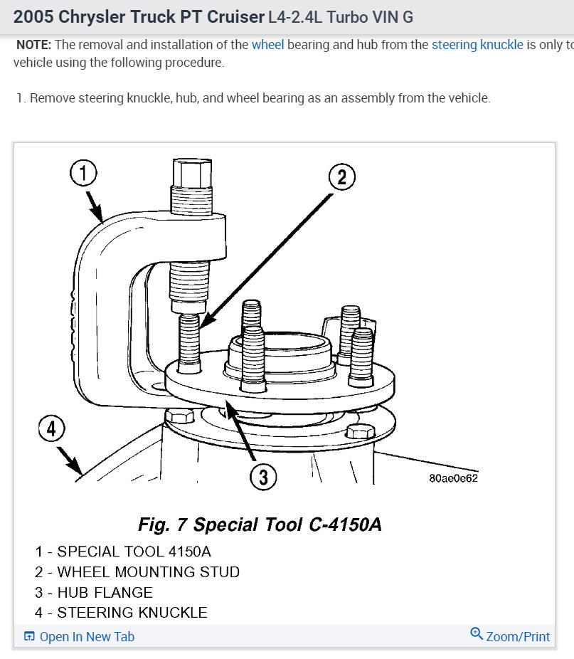

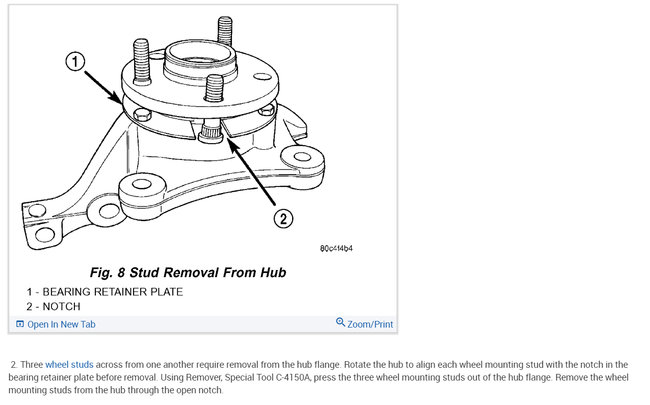

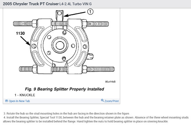

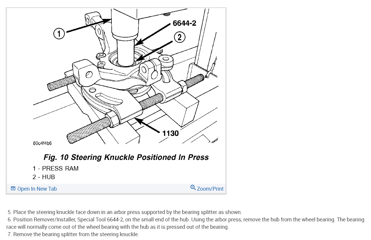

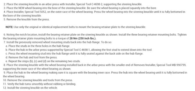

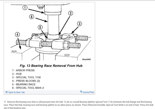

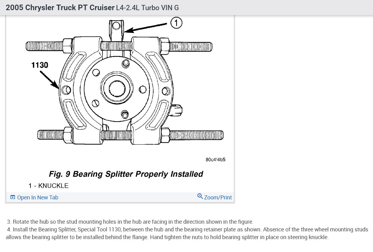

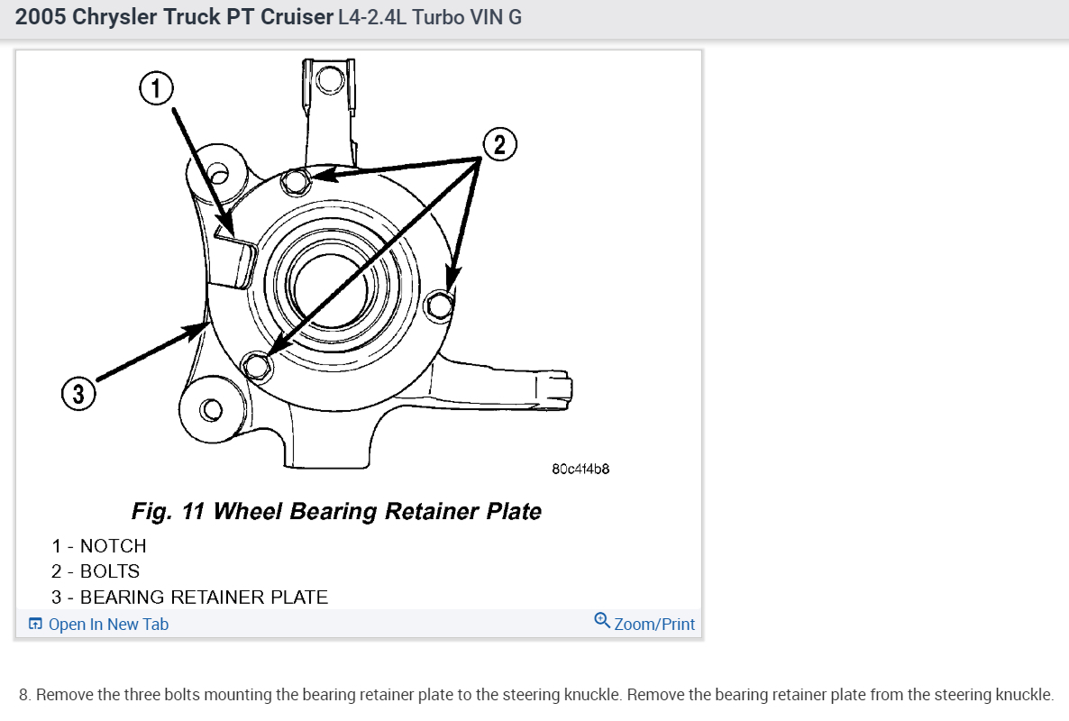

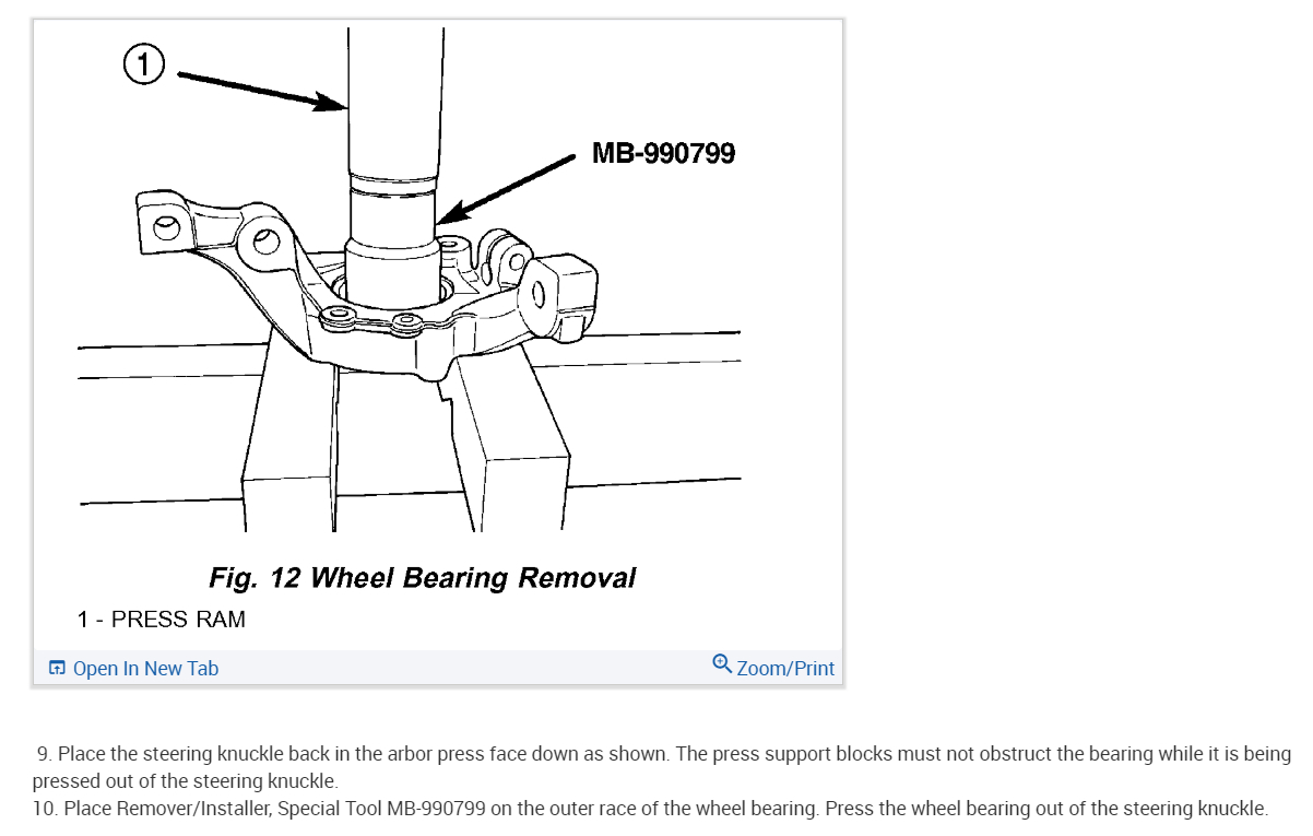

While driving and hearing the noise, if you make left or right turns does the sound change? It may also go away when using the brake telling you an axle bearing is out here is a guide that shows the steps on how to replace them and diagrams below to show you on your car.
https://www.2carpros.com/articles/how-to-replace-a-cv-axle-bearing
