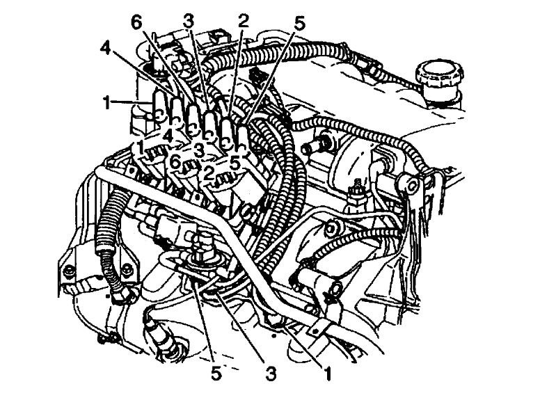

So I have a spark plug that is stuck inside the hole. The end snapped off of it where the socket goes on and now there is just park of the metal sticking out. I tried a reverse tap and the tap broke off inside the end of the spark plug. Now what do i do? The spark plug is on the backside of the engine too so there isnt' alot of room to get around i need the firing order.

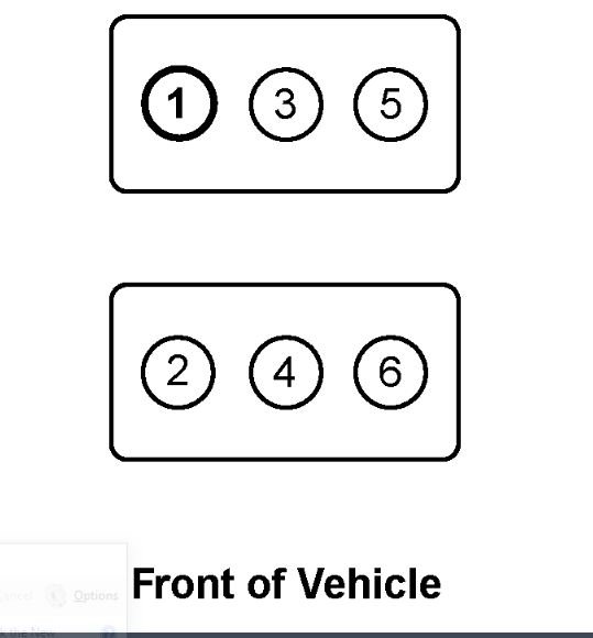

Hello, I'm Danny.
Here is the firing order information you've requested. I've attached the 2 pictures below. Hope this helps and thanks for using 2CarPros.

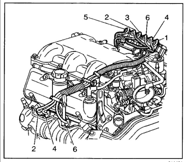

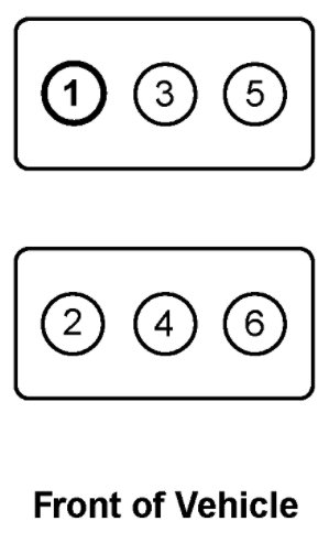

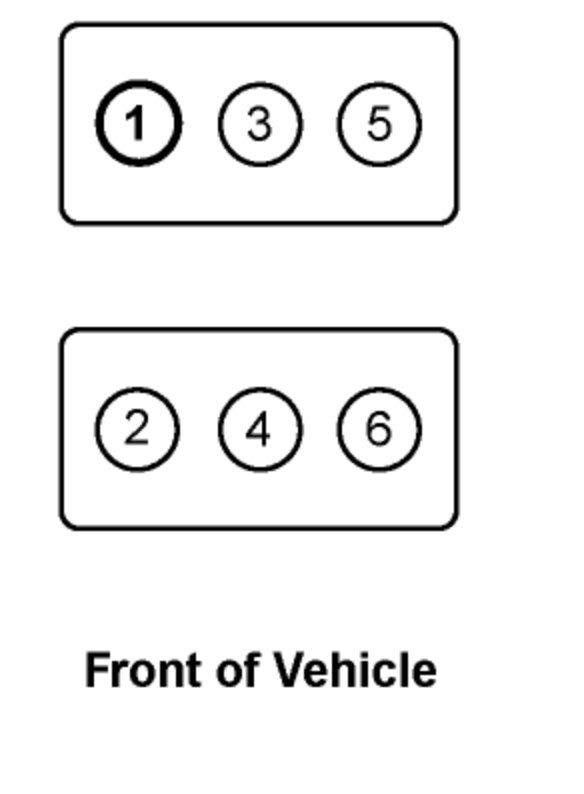

The firing order for your engine is:
Firing Order 1-2-3-4-5-6
Here are diagrams below to help you see how to route the plug wires.
Check out the diagrams (below)

Good afternoon.
Do you have the 3.1 or the 3.4? Makes a difference.
Okay, found the cylinder location and the coil wire connections.

can't tell you without knowing what the motor is. but if it is a 3.4 the firing order is 123456 and is sequencial . when you ask for a firing order need to say what motor.....
