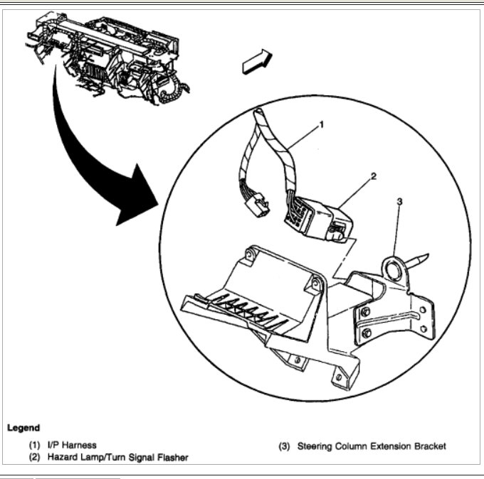

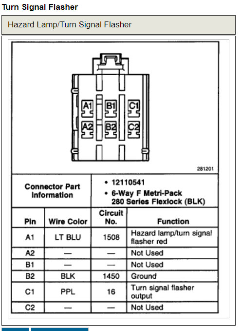

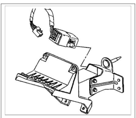

Electrical problem 6 cyl Front Wheel Drive Automatic 357000 miles
My directionals, flashers only work intermittently, where is the flasher located to enable replacement?
Mar 23, 2010 at 11:45 AM
  • CAR REPAIR CONTRIBUTOR
  • 54,346 POSTS
The turn signal flasher is located at the steering column. You need to remove the trim panel to access it. Here are some diagrams (Below) of its location.
