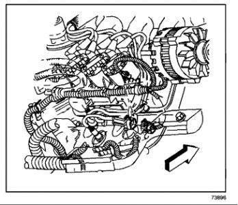

How to change oxygen sensor?

1998 Chevy Truck Venture V6-3.4L VIN E
HO2S 1 Replacement
https://www.2carpros.com/forum/automotive_pictures/12900_os1_1.gif
https://www.2carpros.com/forum/automotive_pictures/12900_os2_1.jpg
https://www.2carpros.com/forum/automotive_pictures/12900_os3_1.gif

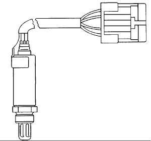

REPLACEMENT
CAUTIONS:
*Do not remove this pigtail from either the heated oxygen sensor (HO2S) or the oxygen sensor (O2S). Removing the pigtail or the connector will affect sensor operation.
*Handle the oxygen sensor carefully. Do not drop the HO2S. Keep the in-line electrical connector and the louvered end free of grease, dirt, or other contaminants. Do not use cleaning solvents of any type.
*Do not repair the wiring, connector or terminals. Replace the oxygen sensor if the pigtail wiring, connector, or terminal is damaged.
*This external clean air reference is obtained by way of the oxygen sensor signal and heater wires. Any attempt to repair the wires, connectors, or terminals could result in the obstruction of the air reference and degraded sensor performance.
*Do not apply contact cleaner or other materials to the sensor or vehicle harness connectors. These materials may get into the sensor causing poor performance.
*Do not damage the sensor pigtail and harness wires in such a way that the wires inside are exposed. This could provide a path for foreign materials to enter the sensor and cause performance problems.
*Ensure the sensor or vehicle lead wires should be bent sharply or kinked. Sharp bends or kinks could block the reference air path through the lead wire.
*Do not remove or defeat the oxygen sensor ground wire (where applicable). Vehicles that utilize the ground wired sensor may rely on this ground as the only ground contact to the sensor. Removal of the ground wire will cause poor engine performance.
*Ensure that the peripheral seal remains intact on the vehicle harness connector in order to prevent damage due to water intrusion. The engine harness may be repaired using Packard's Crimp and Splice Seals Terminal Repair Kit. Under no circumstances should repairs be soldered since this could result in the air reference being obstructed.
*The heated oxygen sensor may be difficult to remove when engine temperature is below 48 C (120 F). Excessive force may damage threads in exhaust manifold.
REMOVE OR DISCONNECT
1.Electrical connector.
2.Using J 39194-B remove HO2S 1.
3.Carefully back out the heated oxygen sensor. NOTE: A special anti seize compound is used on the heated oxygen sensor threads. The compound consists of graphite suspended in fluid and glass beads. The graphite will burn away, but the glass beads will remain, making the sensor easier to remove. New or service sensors will already have the compound applied to the threads. If a sensor is removed from an engine and if for any reason is to be reinstalled, the threads must have anti seize compound applied before reinstallation.
INSTALL OR CONNECT
1.Coat the threads of heated oxygen sensor/catalyst monitor with anti seize compound P/N 5613695, or equivalent if necessary.
2.Install and tighten the HO2S 1 (Precatalytic converter) to 42 4 N.m (31 lb ft) .
3.Electrical connector.

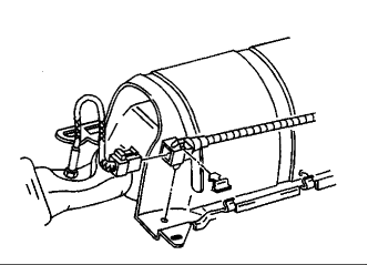

HO2S 2 Replacement
https://www.2carpros.com/forum/automotive_pictures/12900_os1_2.gif
https://www.2carpros.com/forum/automotive_pictures/12900_os4_1.gif
REPLACEMENT
CAUTIONS:
1.Raise and support vehicle.
2.Electrical connector.
INSTALL OR CONNECT
2.Install and tighten the HO2S 2 to 42 4 N.m (31 lb ft) .
4.Lower the vehicle.
