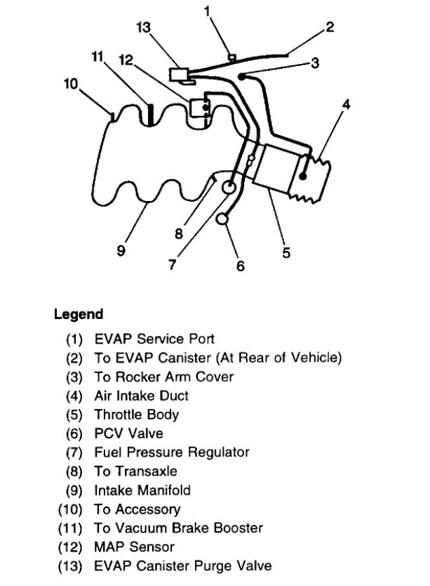

Could you please tell me where the thermostat is located on the engine? Thanks
+1
Wednesday, April 12th, 2017 AT 7:14 PM (Merged)
RHALL77
  • 3,361 POSTS
It is located on the back side of the engine below the throttle body
