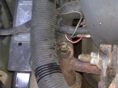

There's a TON of people that have this exact same problem with Chevy Ventures. I was one of them... It is a MAJOR PAIN IN THE REAR to get the air out of the coolant system! Sounds like the problem.. also, b careful cuz ive been told that due to the aluminum heads, they are very prone to blown head gaskets, warping etc. after even only one overheat...
There is (actually two) bleeder screws on the coolant system. I use the one on the passenger side of the vehicle because its higher and better to let out extra air... Its located about ten inches to the left of the oil fill cap. It has a hex head (cant remember the size) and its very simple to bleed the air out by unscrewing it a few turns and bleed until coolant streams out. This process took me like two days of repeating until finally my temp gauge and everything is back to normal...

The answer I got from Niz76 was awesome to stop my overheating of my engine and get my heater to blow hot air in my 1997 Chevy venture. It took me 20 minutes to pop the rad cap, release the bleeder nut on the left hand side and start the van and squeeze the hoses on both sides while the van was running. As soon as the antifreeze started running out of the bleeder nut hole, I tightened the bleeder nut and put the rad cap back on tight and took the van for a boot around the block a few times. Problem fixed, no overheating, and awesome hot heat. THANKYOU
