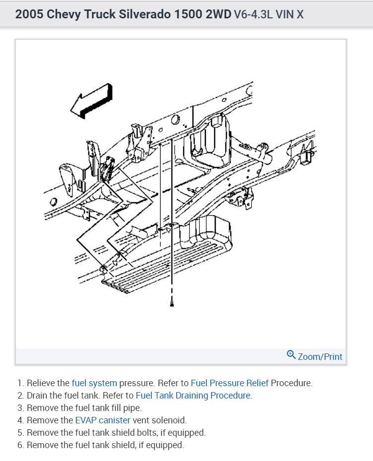

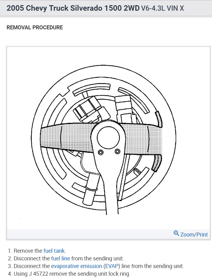

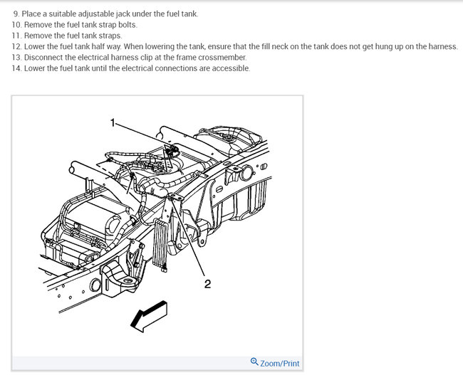

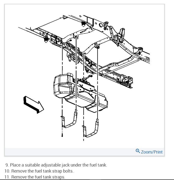

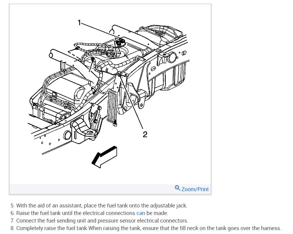

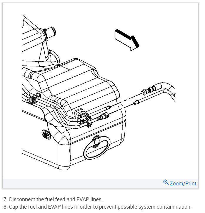

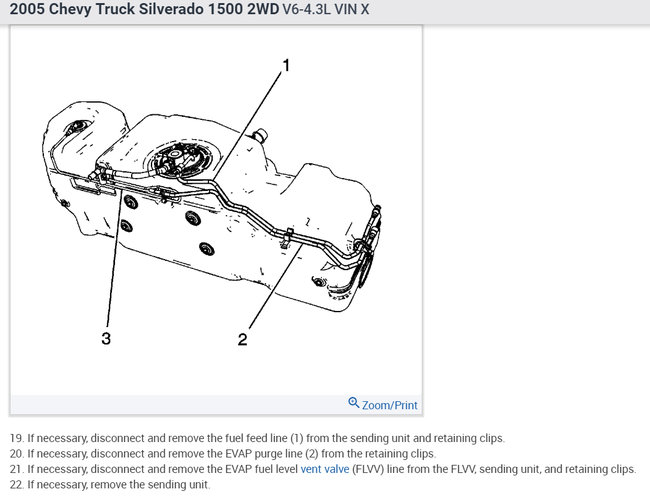

It sounds like the fuel level sensor in the tank is bad. the only fix is to drop the tank and replace the sender unit. (note: fuel pump might be part of the unit) Check out the diagrams (Below). Let us know what happens and please upload pictures or videos of the problem.

To test the gauge circuit you must ground the feed wire to the gauge, it should go all the way full, then open the circuit, it should go all the way down to empty. if so your sender is bad and needs to be replaced. A mechanic will charge you about 180.00 to remove the tank, by the part on the internet and it will cost you about 290.00 if you go to the dealer it will cost about 590.00 please let me know how it goes.
