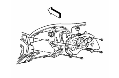

MPVINCLER
  • 2004 CHEVROLET TRAILBLAZER
  • 4WD
How to remove chevy trail blazer instrument cluster
Wednesday, May 20th, 2020 AT 1:07 PM (Merged)
JDL
  • 16,098 POSTS
Remove the left closeout insulator panel. Remove the knee bolster trim panel. Remove the instrument panel cluster bezel. Remove the screws retaining the ipc to i/p. Partially remove the ipc from the i/p in order to gain access to the electrical connector. Disconnect the electrical connector from the ipc. Remove the ipc from the i/p.
