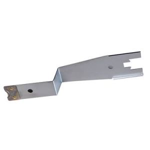

I have a 2003 chev silverado 2500 and I need to know how to remove the interior door panel in order to fix a manual window. I have not been able to figure out how to remove the window handle please help

There is a tool to remove the handle all that is holding the handle on is almost like a pin the tool pushes the pin in and you can then just pull off the window handle you can get the part at any auto parts store or even a car audio place since they are commonly used in the installation of new door speakers also
http://www.2carpros.com/forum/automotive_pictures/110280_window_tool_1.jpg
