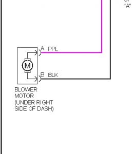

What could be wrong. The core is fine and there is hot air at the vents but it wont blow out? Also how do I fix this on my own?

If you think the problem is the blower motor, check blower connector for voltage and ground. Purple is voltage and black is ground. Check with key on, hvac on. If you have good voltage and ground with no blower action, suspect the blower motor. If no voltage check applicable fuses.
http://www.2carpros.com/forum/automotive_pictures/170934_silverado_blower_motor_1.jpg
