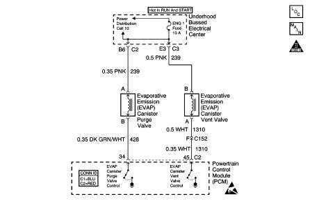

My Silverado is bucking when I slightly hold the gas around 55 mph. I recently had the fuel pump and filter changed. It is throwing code po449 (evaporative emission control vent/solenoid control circuit malfunction). If this is causing the bucking, how do I fix it?

The bucking sounds more like an engine misfire. Check your plugs and wires for carbon tracking on the sides of the plugs. Below is a flow chart for the p0449 code.

2000 Chevrolet Chevy K Silverado - 4WD | Sierra, Silverado, Suburban, Tahoe, Yukon (VIN C/K) Service Manual | Document ID: 546856
DTC P0449 Evaporative Emission (EVAP) Vent Solenoid Control Circuit
Circuit Description
A voltage is supplied directly to the evaporative emission (EVAP) vent valve solenoid. The powertrain control module (PCM) controls the solenoid by grounding the control circuit via an internal switch called a driver. The primary function of the driver is to supply the ground for the controlled component. Each driver has a fault line which the PCM monitors. The voltage of the control circuit should be low, near 0 volts, when the PCM commands a component ON. The voltage potential of the circuit should be high, near the battery voltage, when the PCM commands the control circuit to a component OFF. If the fault detection circuit senses a voltage other than what the PCM expects, the fault line status changes causing the DTC to set.

Test Description
The numbers below refer to the step numbers on the diagnostic table.
Listen for an audible click when the solenoid operates. Be sure that both the ON and the OFF states are commanded. Repeat the commands as necessary.
This test can detect a partially shorted coil which would cause excessive current flow. Leaving the circuit energized for 2 minutes allows the coil to warm up. When warm the coil may open (amps drop to 0) or short (goes above 0.75 amp).
Momentarily probe the solenoid control circuit to ground. Listen for an audible click when the solenoid operates.
If no trouble is found in the control circuit or the connection at the PCM, the PCM may be faulty, however, this is an extremely unlikely failure.

© 2008 General Motors Corporation. All rights reserved.
https://www.2carpros.com/forum/automotive_pictures/102900_121212_1.jpg
