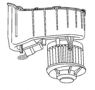

Here is a guide to help you step by step with instructions in the diagrams below to show you how on your car.
https://www.2carpros.com/articles/blower-fan-motor-works-on-high-speed-only
REMOVAL PROCEDURE
https://www.2carpros.com/forum/automotive_pictures/12900_bmc1_2.gif
1.Remove the sound insulator panel.
2.Disconnect the electrical connector (2) from the blower motor (1).
3.Remove the screws from the blower motor (1).
4.Remove the blower motor (1) from the HVAC module (3).
5.Remove the retainer from the blower motor impeller. Discard the retainer.
6.Remove the blower motor impeller from the blower motor (1).
INSTALLATION PROCEDURE:
1.Install the blower motor impeller to the blower motor (1).
2.Install the new retainer to the blower motor impeller.
3.Install the blower motor (1) to the HVAC module (3). NOTE: Refer to Fastener Notice in Service Precautions.
4.Install the screws to the blower motor (1). Tighten Tighten the screws to 2 N.m (18 lb in) .
https://www.2carpros.com/forum/automotive_pictures/12900_bmc2_1.gif
5.Connect the electrical connector (2) to the blower motor (1).
6.Install the sound insulator panel
