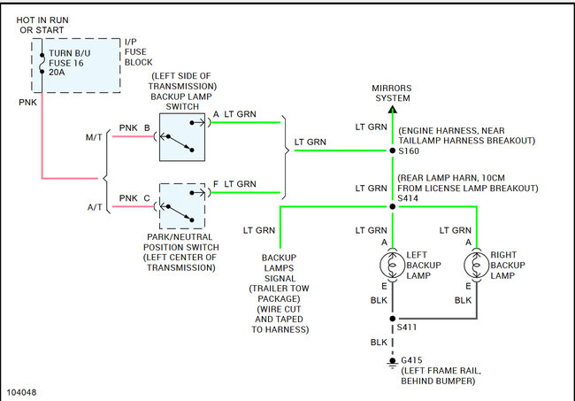

ive replaced both of my back up reverse lights just recently after i noticed they went out. ive checked all the fuses just inside the door. is there a relay or switch or fuse that i dont know about as to why i cant figure out why i cant get them to come back on?

Inspect and test the park and neutral position switch at left center of transmission. Check out the images (below). Let us know how it goes
