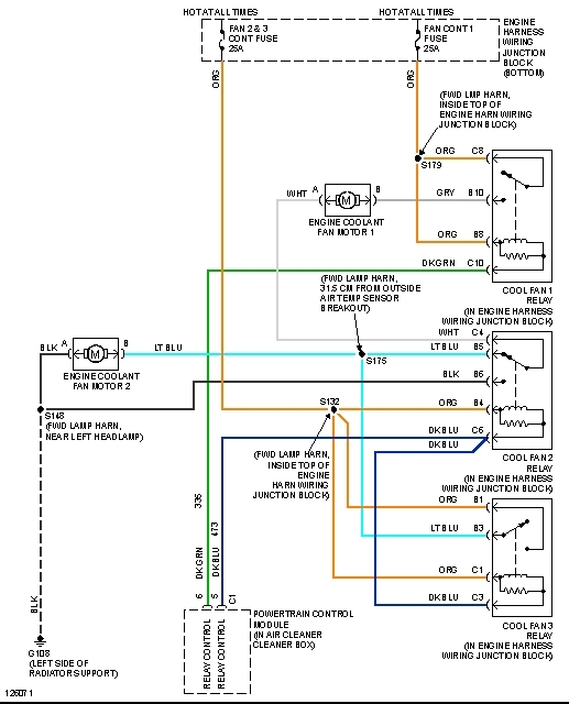

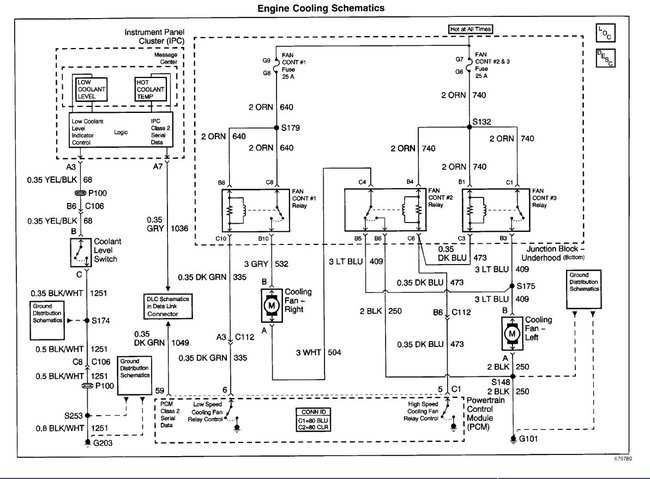

I noticed my car running hot at idle and in traffic. I checked the fuses and electric cooling fans for obstructions and nothing. I tried turning on the AC to see if that would work and nothing. I dont know how to check to see if it is a relay issue. I dont want to buy new relays or sensors unless I need to. Any advice would be appreciated. Thank you for your time!

Buck, Unplug the two wire connector from cooling fan, connect test light to the two wires, start engine & turn on a/c, if tester lights up, replace cooling fan motor. If it doesnt find the relay, there are usually a couple that are just alike, swap one temperarily & if that fixes it swap em back & get a new one. Dont forget to plug two wires back into fan motor when doing this test!
Hope this helps,
Billybob
