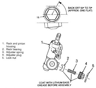

hi I would like to know how to take out the rack do you have any pictures to show how this is done thank you Steve

Below are removal/installation procedures for your rack and pinion.
REMOVAL:

Bleed the power steering system then make adjustments by doing the following.
ADJUSTMENT:
Make the adjustment with the front wheels raised and centered. Make sure to check the returnability of the steering wheel to center after the adjustment.
((Rack bearing preload adjustment))
http://www.2carpros.com/forum/automotive_pictures/261618_0900c15280068229_1.jpg
Loosen the adjuster plug locknut and turn the adjuster plug clockwise until it bottoms in the housing, then back OFF 50 to 70 degrees (about one flat).
Tighten the locknut on the adjuster plug. Hold the adjuster plug in place while tightening.
