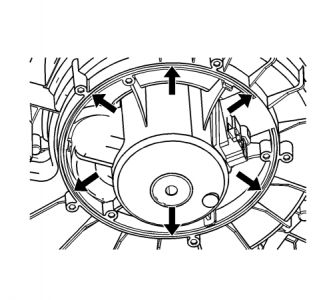

If you feel it is just the blower motor itself that is faulty, below are removal/installation instructions for the component.
REMOVAL:
Remove the right closeout panel.
Remove the blower motor wire harness connector.
Cut out the blower motor using a utility knife in the narrow groove of the lower case (FIG. 1)
FIGURE 1
https://www.2carpros.com/forum/automotive_pictures/261618_0900c15280094d67_1.jpg
NOTE: Cut through the case as straight as possible because the motor cup must be replaced.
In order to prevent damage to the component, do not cut any deeper than necessary to remove the motor cup.
Remove the blower motor.
INSTALLATION:
Install the motor blower seal. (FIG. 2)
FIGURE 2
https://www.2carpros.com/forum/automotive_pictures/261618_0900c15280094d67_2.jpg
Install the blower motor.
Install the blower motor attachment ring if reusing the blower motor.
Tighten the blower motor screws, and tighten the screws to 13 lb inches (1.5 Nm).
Install the blower motor wire harness connector.
Install the right closeout panel.
