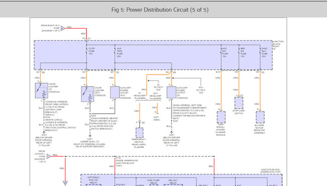

I have a 2003 chevy impala the cigarette outlets aren't getting power. I checked the connections behind the ash tray it's fine and I checked the fuse it looks good. How do I get power to my cigarette outlets

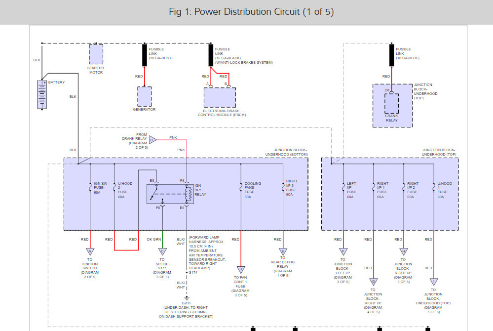

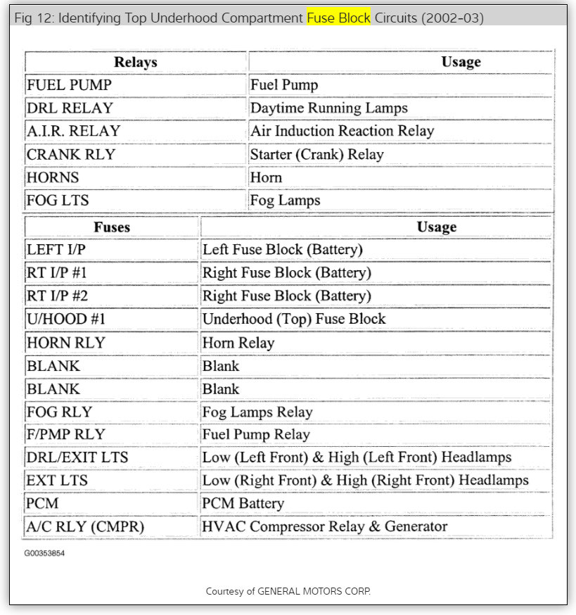

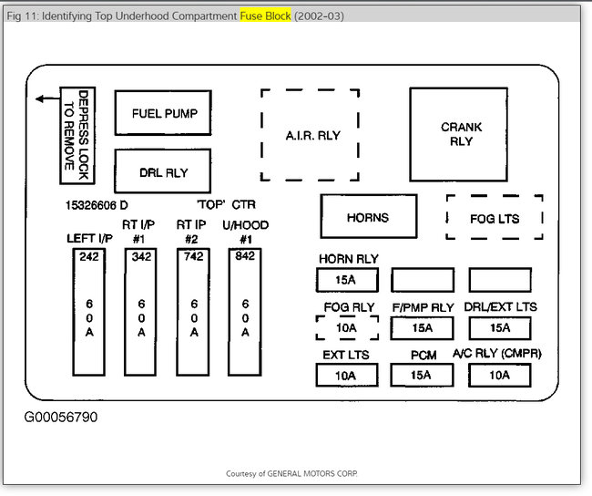

There is a right I/P fuse 60 amp in the under hood fuse panel here is a guide to help you test it and the fuse location with the wiring diagrams so you can see how the system works.
Check out the diagrams (Below). Please let us know what you find. We are interested to see what it is.

I have the same problem. The Aux light does not illuminate. I have no voltage at either the front console or rear console outlets. As illustrated in the schematic I found the 60 amp fuse was blown! Thanks for the post.

My cigarette lighter contnues to blow fuses. I'll put a new one in and it will not blow until I put something (i.E. Phone charger, radar detector) into the socket and it gets moved. As long as it doesn't get bumped or moved in the socket it doesn't blow the fuse. Any suggestions? Where can I find a wiring diagram for the lighter? I have a book but it doesn't have that diagram.

Welcome to the forum, my wiring info shows below picture. Maybe you need a new socket? My other suggestion is, don't bump it. lol
https://www.2carpros.com/forum/automotive_pictures/170934_cigar_liter_1.jpg
