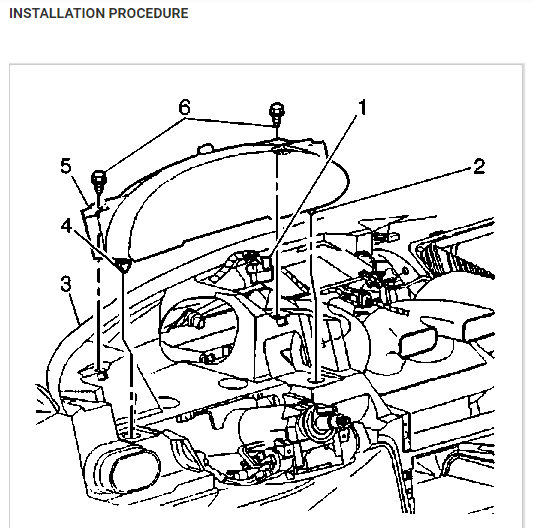

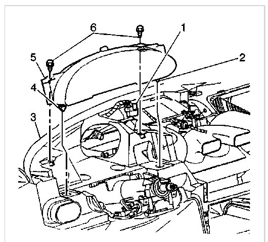

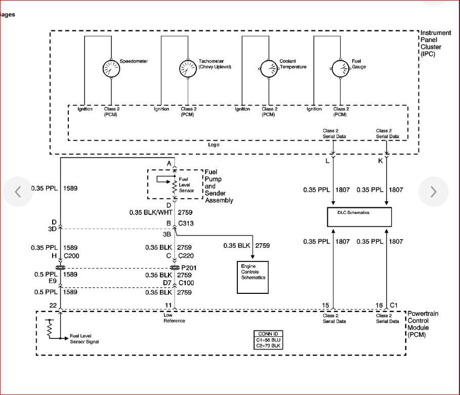

The Speedometer, Thermostat, and Gas guage do not work in my car. They do some times shake, and stutter. Once in a blue moon they will come on. How can I try to fix these problems without immediatley spending more money than I should?
Do you
have the same problem?
Monday, July 5th, 2010 AT 2:15 AM
BLUELIGHTNIN6
  • EXPERT
Hello and thanks for donating

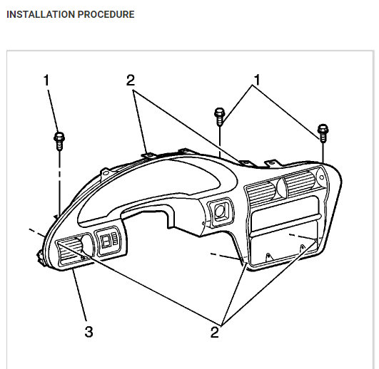

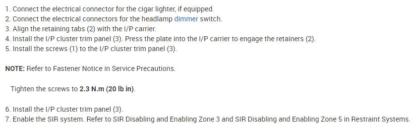

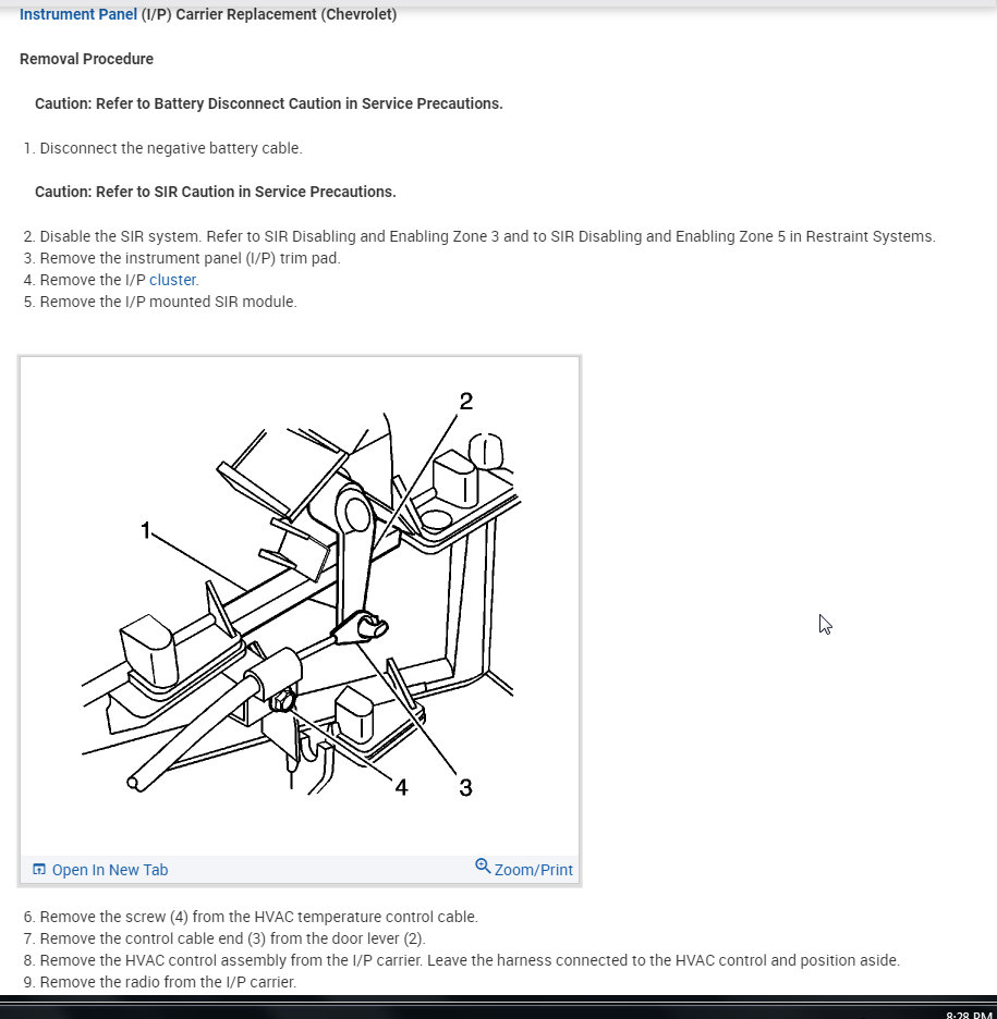

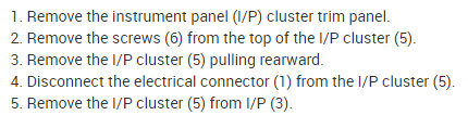

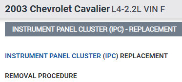

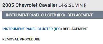

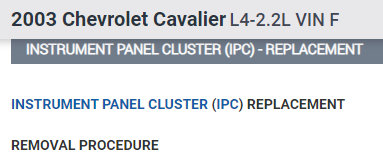

These three gauges are not related to each other as far as the sending units that drive them, so that eliminates faulty sending units / sensors. The most likely culprit would be a faulty instrument gauge cluster itself, but first you would want to pull out the gauge cluster and inspect the wiring to it as well as the circuit board on the back of it.
