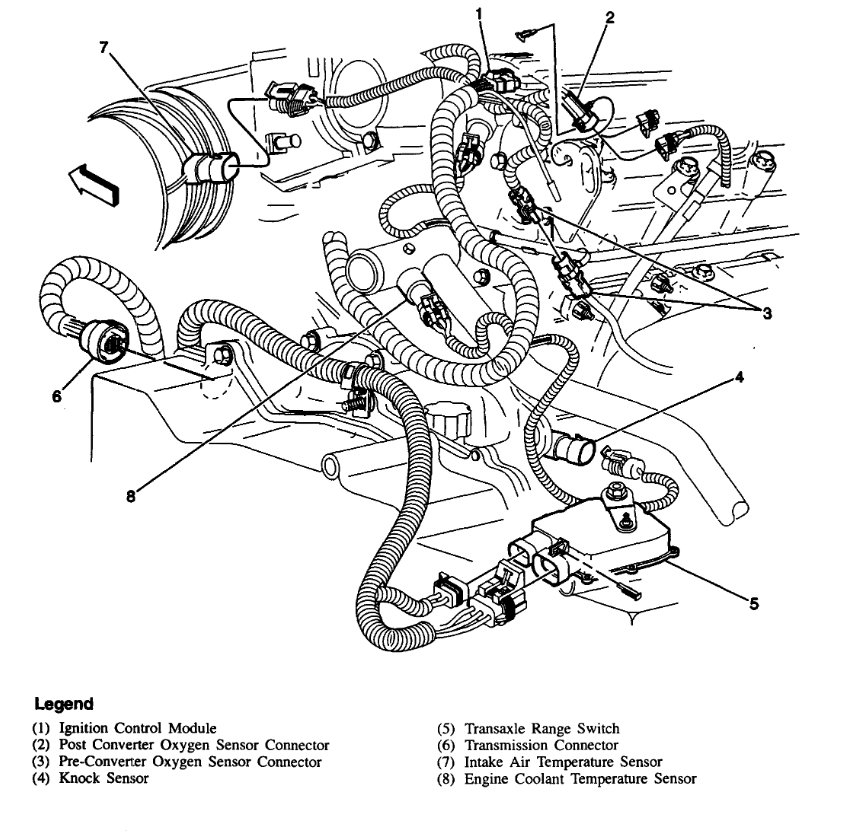

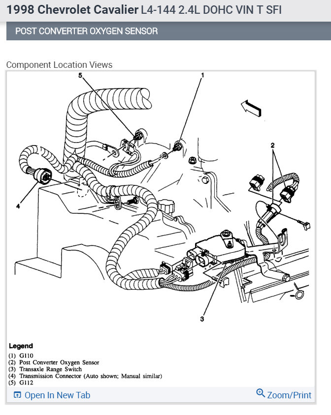

It should be on the slip. It will start with a "P" followed by four-digit number. These are some of examples for heated oxygen sensor for Bank 1 Sensor 2. P0036 HO2S Heater Control Circuit (Bank 1 Sensor 2) P0037 HO2S Heater Control Circuit Low (Bank 1 Sensor 2) P0038 HO2S Heater Control Circuit High (Bank 1 Sensor 2) P0139 02 Sensor Circuit Slow Response (Bank 1 Sensor 2) P0140 02 Sensor Circuit No Activity Detected (Bank 1 Sensor 2) P0141 02 Sensor Heater Circuit Malfunction (Bank 1 Sensor 2) Description: Bank 1: Bank means cylinder head. In your case, you only have one bank (Bank 1). Locate your exhaust pipe. Sensor 1 is the one by the exhaust manifold and sensor 2 is the one after the catalytic converter. Sensor 1 sometimes is also called pre-cat sensor, and Sensor 2 called post-cat sensor. You have go under the car, locate the cat in the exhaust pipe, and you should see a 4-wire sensor attached to the exhaust pipe.
https://images.2carpros.com/forum/automotive_pictures/55316_98cavunderhood_1.jpg
https://images.2carpros.com/forum/automotive_pictures/55316_o2sensor_1.jpg
