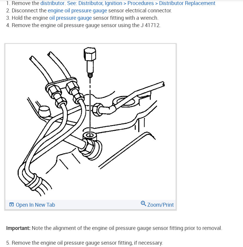

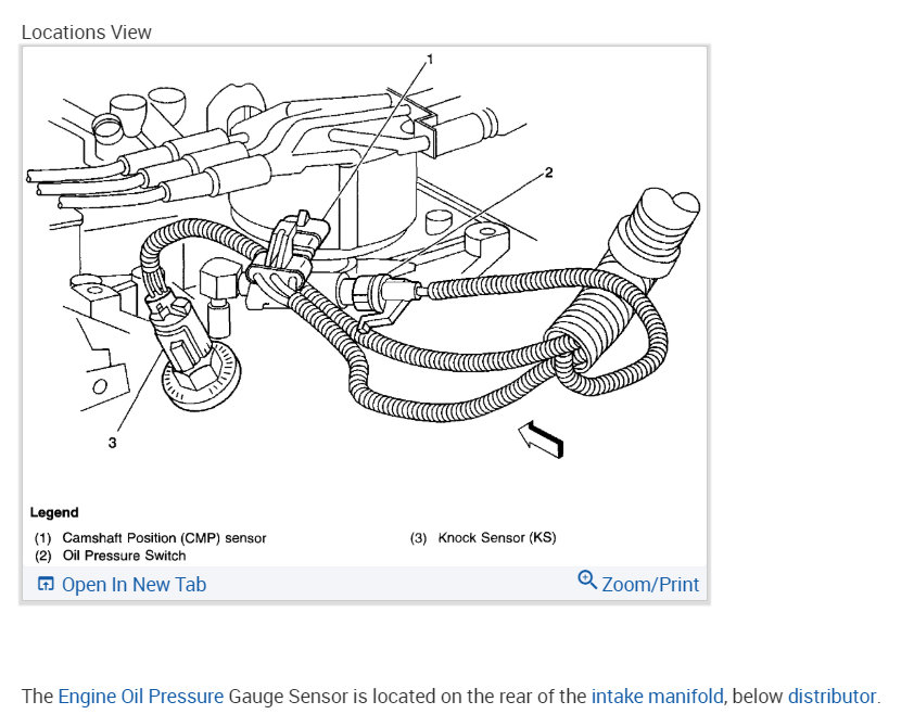

Engine oil pressure (EOP) sensor is on the top rear of the engine, near the distributor for the 4.3L motor. yes it does have a 2 prong connector this pic below should help pinpoint it If security light is flashing than that is what is stopping power to the fuel pump, not the oil pressure sensor. Try using a spare key to see if that helps.

Well, thanks for the pic but that's not what what my engine configuration looks like. Vehicle is a 2002 ZR2 Blazer.

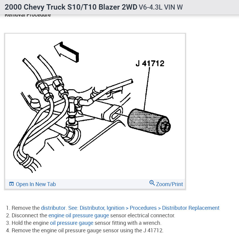

Sorry, my mistake. I found it with the help of your diagram. Had to pull the distributor to get at it.

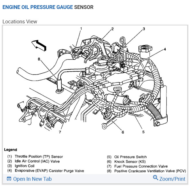

your vehicle uses an oil pressure sensor and it is located on the top rear of engine, near the distributor. Check out the diagrams (Below). Please let us know if you need anything else to get the problem fixed.

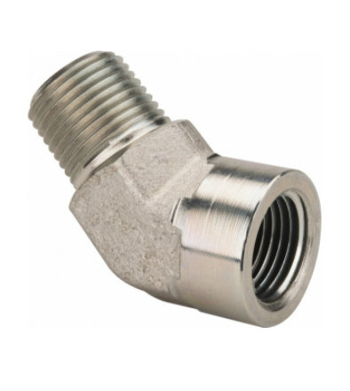

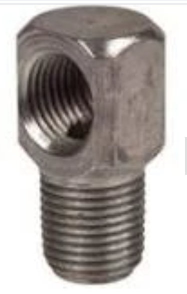

Normally when you buy an oil pressure switch or sending unit they are one-eighth inch pipe threads. They sometimes come with an adapter for the one-quart inch threads in the engine block. They also make 45 and 90 degree adapters to gain easier access or clearance as well for the distributor or firewall. I've attached pictures below of a new oil pressure sending unit as well as what a 45 and 90 degree adapter elbow looks like. Hope this helps and thanks for using 2CarPros.
