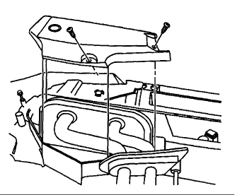

BLUELIGHTNIN6
  • 16,542 POSTS
Heres the best way to describe how to replace heater core in a 2000 blazer..
https://www.2carpros.com/forum/automotive_pictures/261618_Noname_1754.jpg

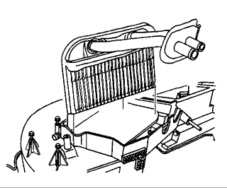

BLUELIGHTNIN6
  • 16,542 POSTS
https://www.2carpros.com/forum/automotive_pictures/261618_Noname_1999.jpg
