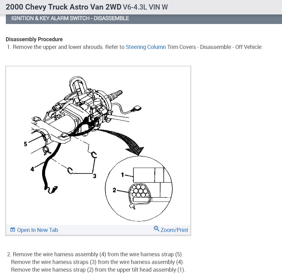

Hello
Electrical system is unpredictable. Sometimes when I turn the key, I get nothing. Nothing at al, no warning lights, nothing, just totally dead. Turn it again and I may get the battery light and nothing else. Or I may get the warning lights and nothing else. Or it may be all normal except it won't crank over. Or, turn it again and everything comes to life as normal. I thought this was likely a bad ignition starter switch, so I ordered and installed one. But nothing changed. Battery voltage is good, cleaned the battery terminals and terminals on the underhood fuse and relay junction box, but still nothing.
Before I crawl under this thing in the snow and check the positive terminal at the starter relay, has anyone seen tis issue before ? Thank You in advance for any info. Regards, Don

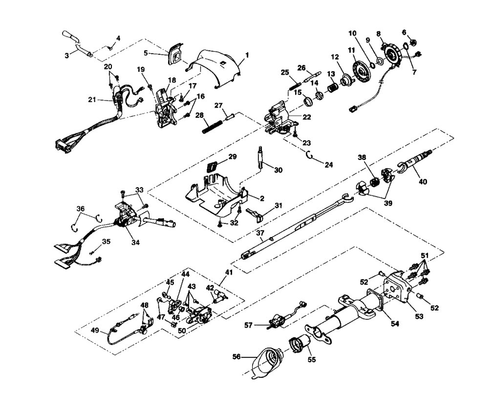

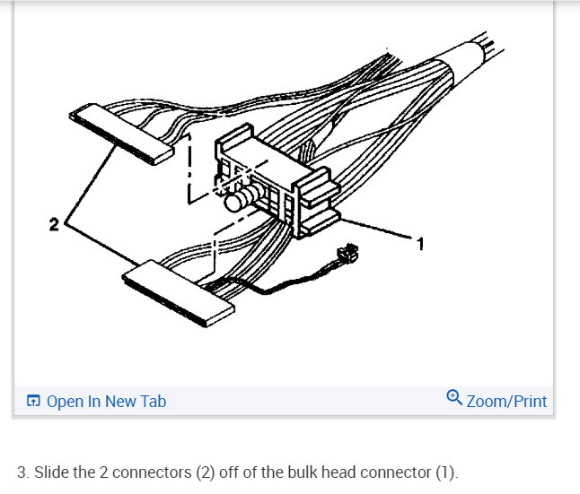

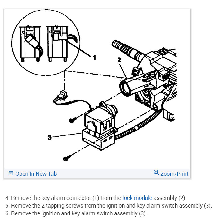

I have seen some strange things come from a bad ignition switch. Go to the fuses for the stereo and heater fan, stuff that only works when key is on. When nothing is working see if there is power to these fuses, if not the switch is most likely the culprit. Here are instruction on how you can change it out in the diagrams below.
