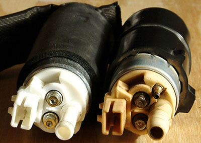

Fuel delivery problem. Wires melted together in unit. Ordered new pump. New pump missing additional hose fitting. Can this pump be used, eliminating small line hookup? Sending pic of both pumps.
Response much appreciated. Thank you. Gary

I strongly recommend getting the same pump.
