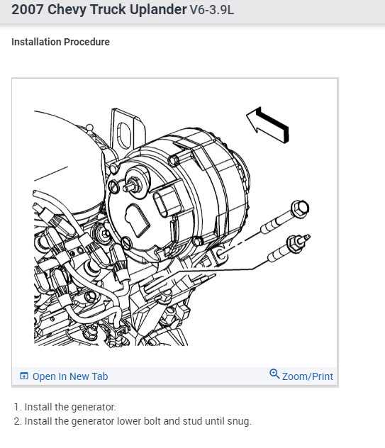

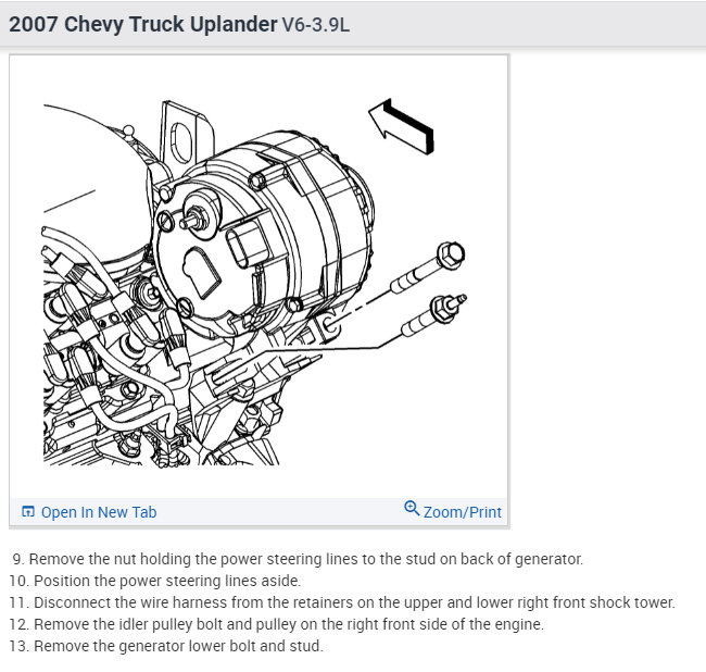

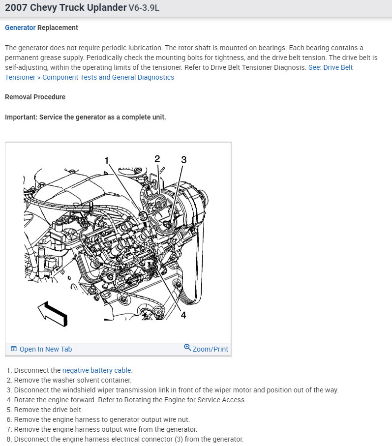

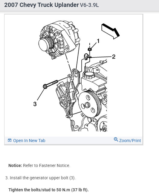

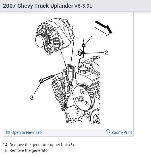

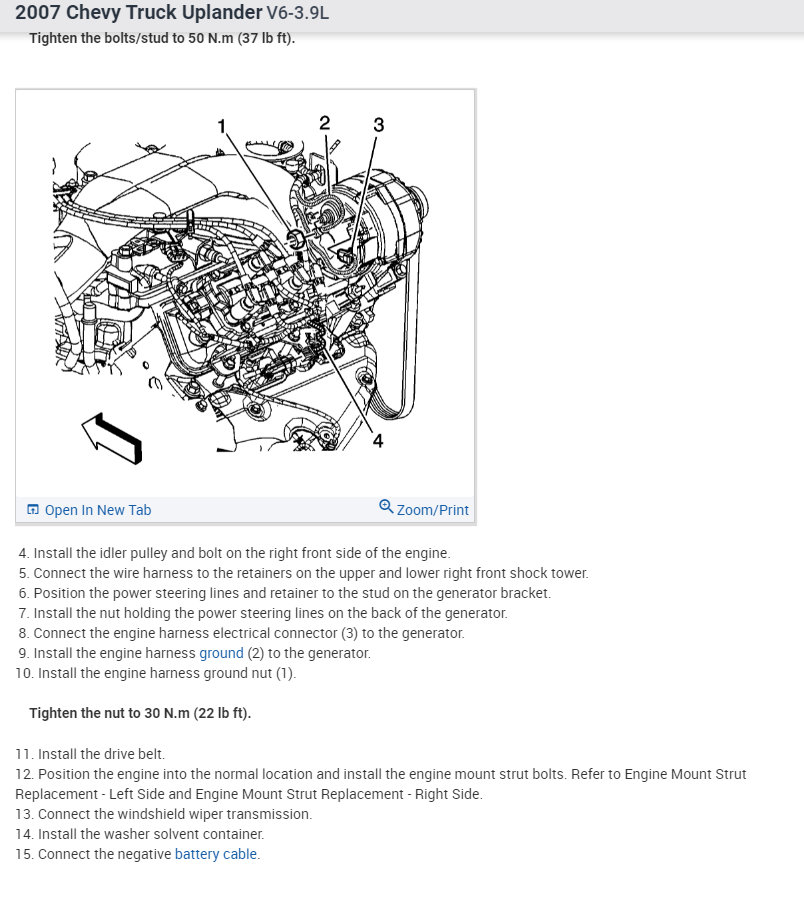

You can also test the alternator by removing it from the vehicle and have it tested at your local auto parts store.
