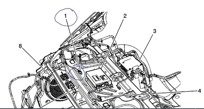

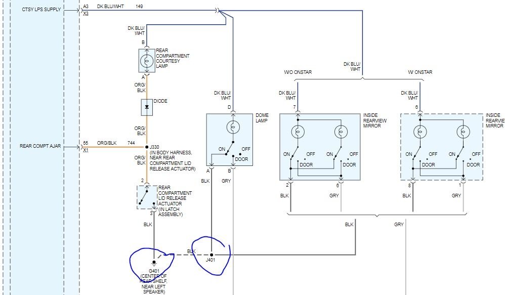

hello, the cargo light does not work anymore. checked fuses. bulbs i did check one side of wires and one dose have power. i am thinking maybe a bad ground. where is this ground on the car? Thank you, Bruce

Good morning,
Yes, it does sound like a ground issue.
I attached a diagram and the location of the ground for the light for you.
Let me know if you have any other questions.
