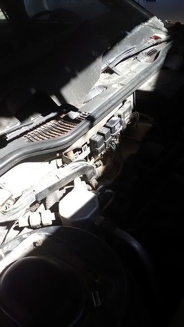

The battery has been disconnected for a day now. I will connect tomorrow and pull codes if any are still on. Picture for attention.
Jan 31, 2020 at 8:31 AM
  • CAR REPAIR CONTRIBUTOR
Sounds good. Let us know what you find with that and we can dig further. Thanks

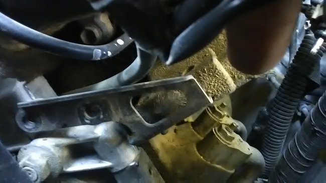

Ordered the ignition coils, it seems there is a loss of power but fidgeting with the TPS (setting left to right) and the sub-TPS it changes way the car accelerates and if it stays on. Right now the car cranks up and idles fine but no power in Drive, have to downshift at start from Low and on to get it pass 40 MPH. Wish I hadn't messed with the sub TPS though. Well see, I will keep posting to this thread. If anyone has the link to the removal procedure for the ignition coils let me know. Thanks!

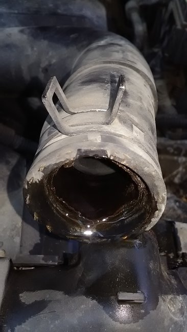

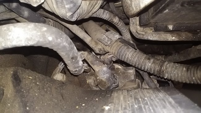

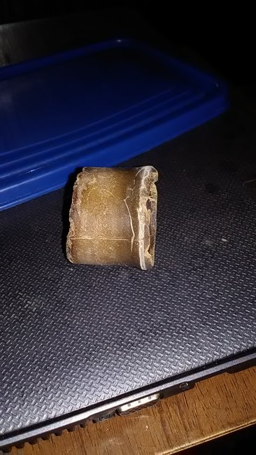

Got two 10mm bolts off the bracket can't see if other bolts. The upper radiator spigot had been broken and I just found that out too. I'm in this for the long haul, lol. thanks for reading.

Yep haha, I got the ignition coil off. it is the original and the screws are beginning to strip. so I am cleaning and once I get some lubricant spray will soak the screws on the bracket to remove easily.

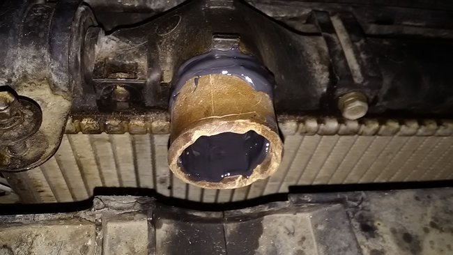

Will jb weld work? Maybe retrofitting another outlet on there? That piece is toast.
Feb 15, 2020 at 5:11 PM
Is that the outlet for the radiator? If so, I would not try to JB Weld it unless you have a large mating surface for the new one to splice onto. If you have just a small area then more than likely it will fail. Otherwise you may be okay.
Feb 15, 2020 at 5:34 PM
BUICK_DUDE
  • 91 POSTS
I am going to need this temp fix before I replace the ignition coils.
Feb 15, 2020 at 5:38 PM
Just don't get the hose clamp over the repaired section or where the crack is because that pressure directly over the crack could compromise it. If you let it set up completely (like overnight) then you should be okay because it is not directly on the bend of the fitting.

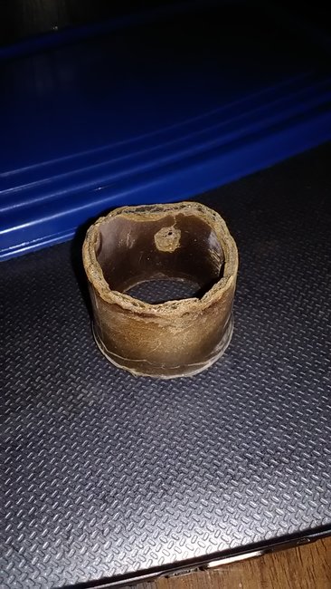

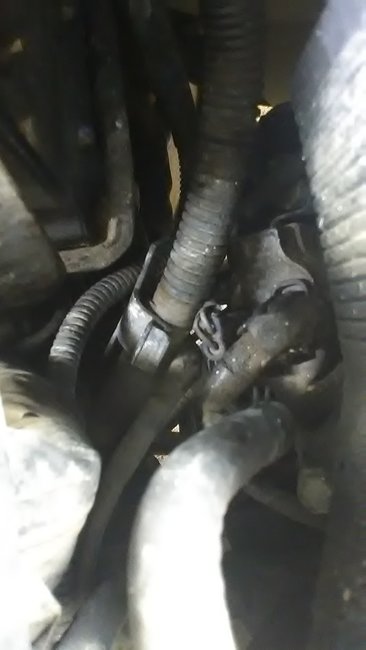

I let it sit for 12 hours then added a second layer covering a larger area around the crack this morning. Just need to see if the coils fix the lack of power from stand still. I will put it back together tomorrow. ECM recapped is on back burner for the moment as well as the radiator, I do not know. Picture for attention.

Replaced both ignition coils. Same problem. Radiator inlet jb weld fix lasted all of 1 mile while test driving.

To fix a radiator with JB or I use marine tex you have to sand the radiator real well with 80 grit then wash it with brake clean to remove oil and grease then put a layer of glue then put a piece of fiberglass cloth over the glue and then work it in with a stick until its set in the glue good. then add another layer of glue and let it set up. That will last years.

Would fiberglass tape work?
Feb 24, 2020 at 10:06 PM
I doubt it. However, it is worth a try if you are not able to replace it at this point.
Feb 25, 2020 at 5:42 PM
BUICK_DUDE
  • 91 POSTS
Tried and failed. Ordered the radiator, went with denso.

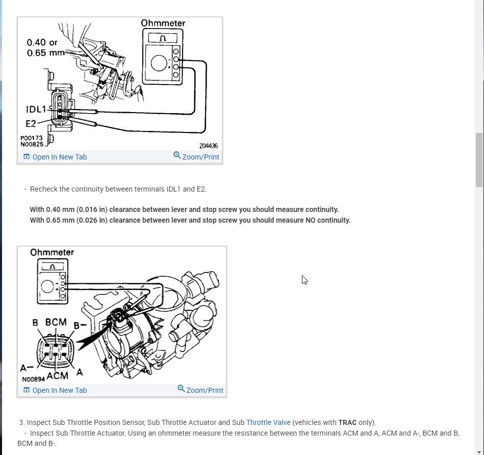

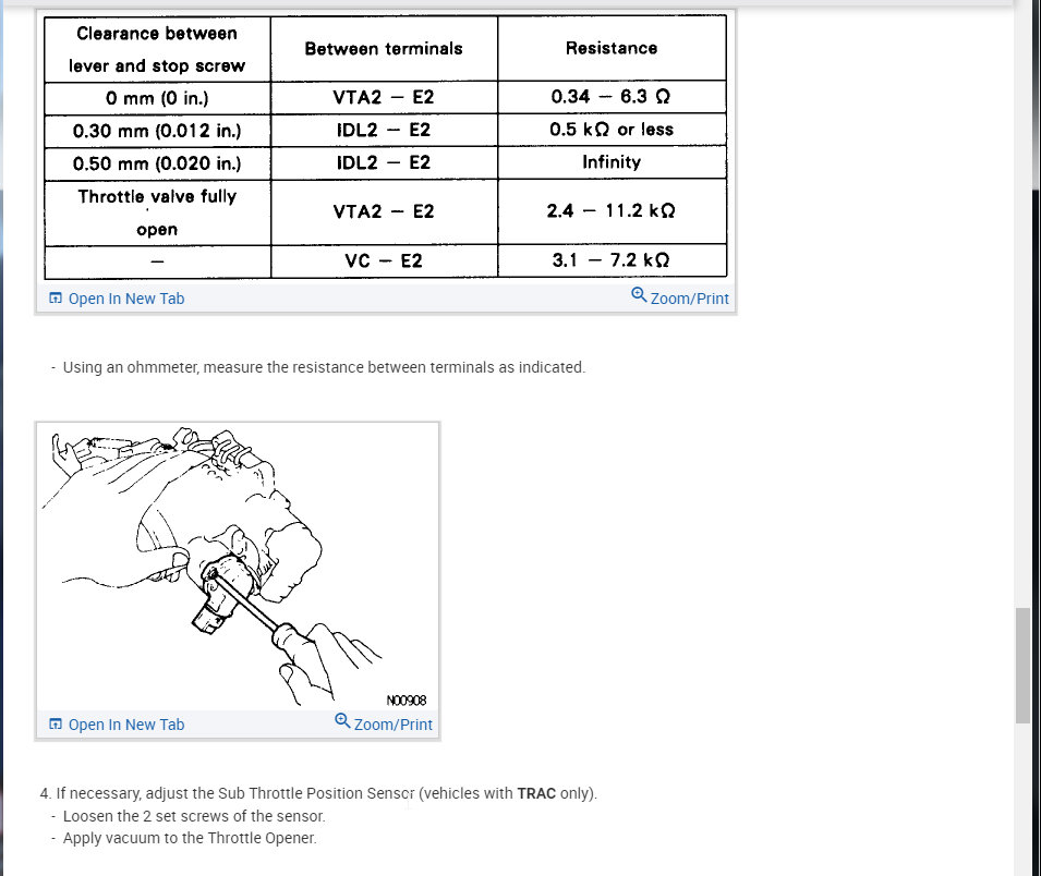

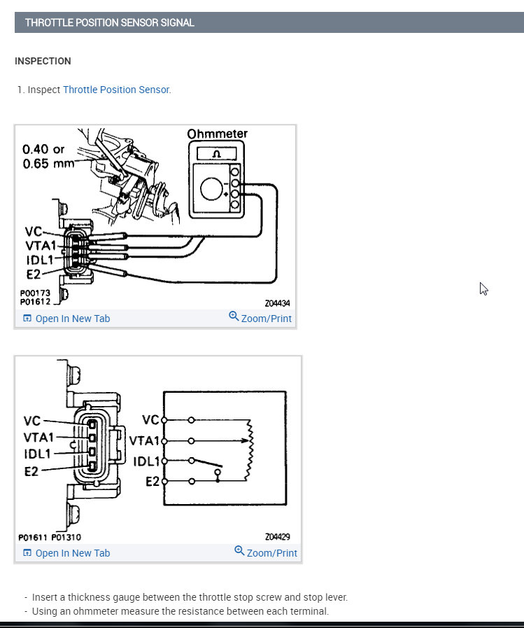

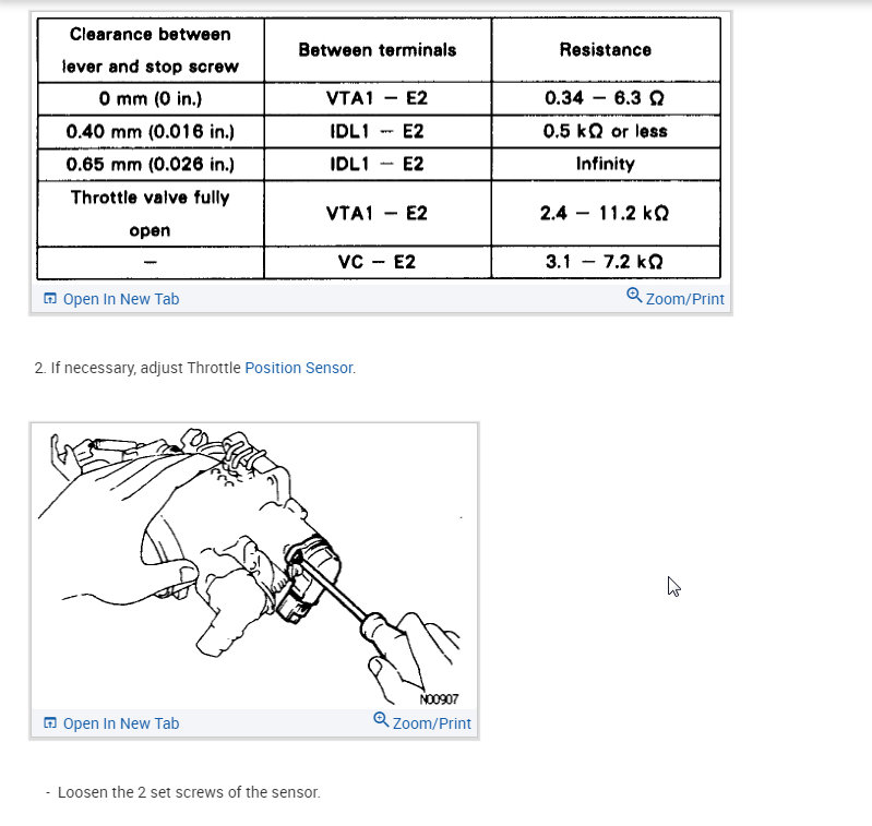

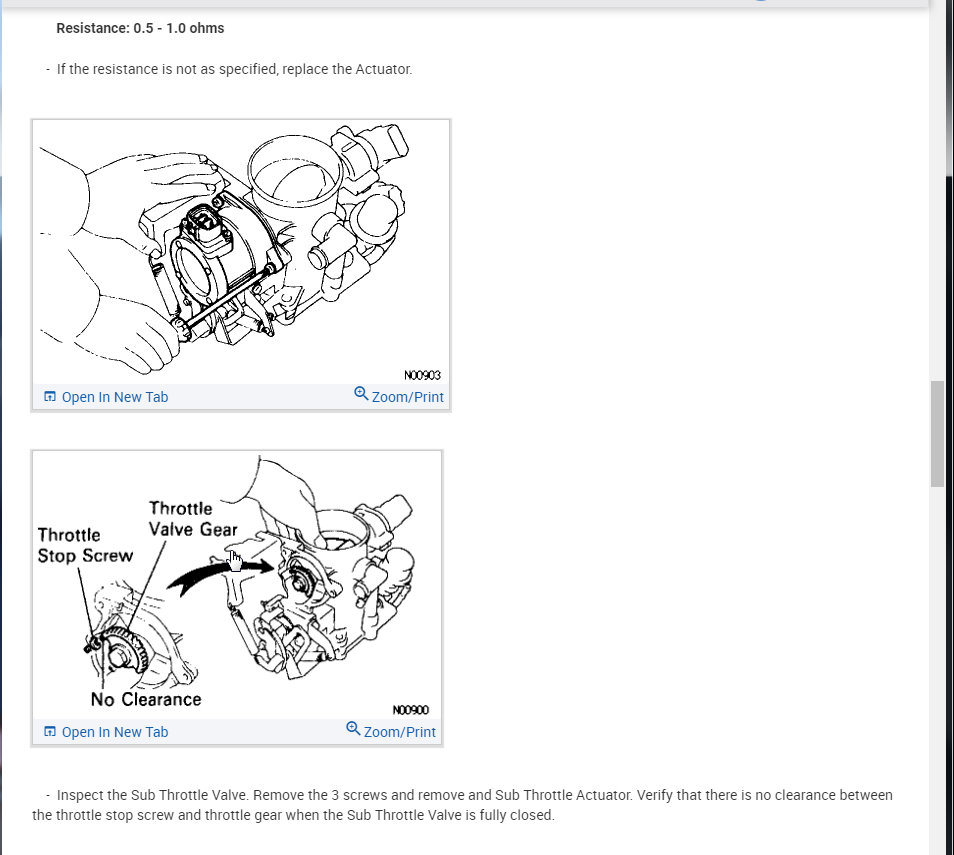

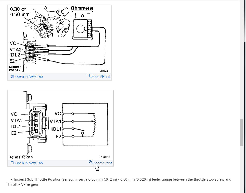

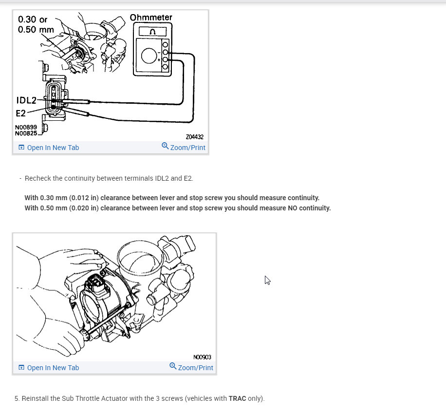

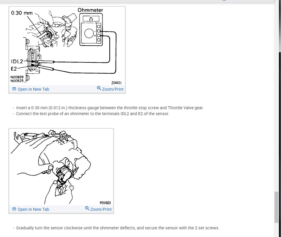

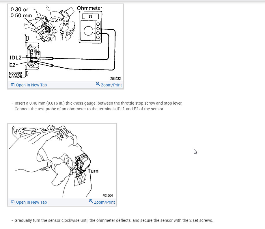

Installed radiator. Red antifreeze. Distilled water. Took a while to fill it up. New rad cap. New hoses. It's no longer overheating. check engine light at 2,000. Need to adjust the TPS again. Doing it manually is a pain. Risk sending car into limp mode. Anyone have any tips?
Mar 28, 2020 at 8:28 PM
I attached the entire process. It is a little involved to adjust the TPS but it is all there. Thanks
