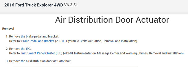

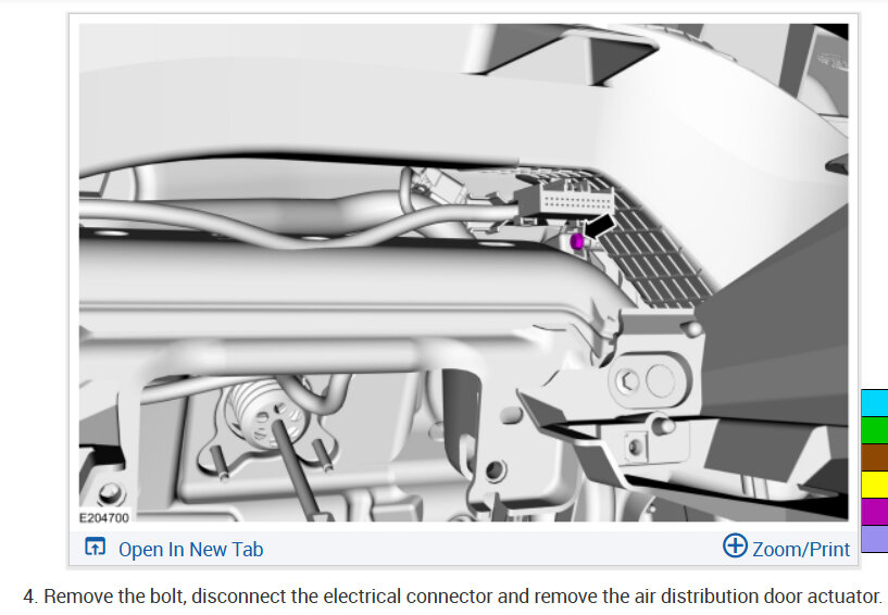

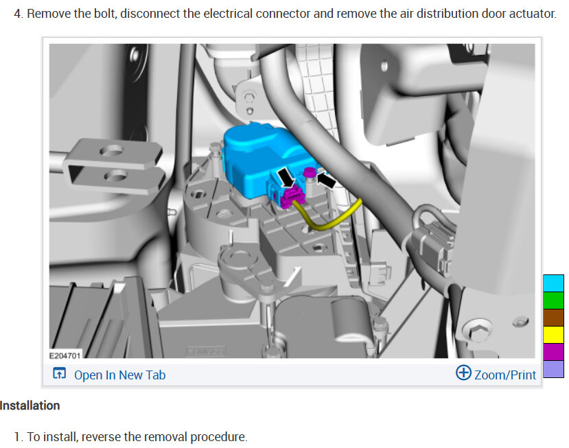

Is this an OEM part? If not, I have seen cheap replacements that have a weak motor that does not work correctly. Just to be clear here is the location of the mode air distribution actuator which there is no relearn procedure needed. Check out the images (below). Please let us know what happens.

Thanks for your response! Yes, it is a Ford replacement part. It is the part shown in the picture.
