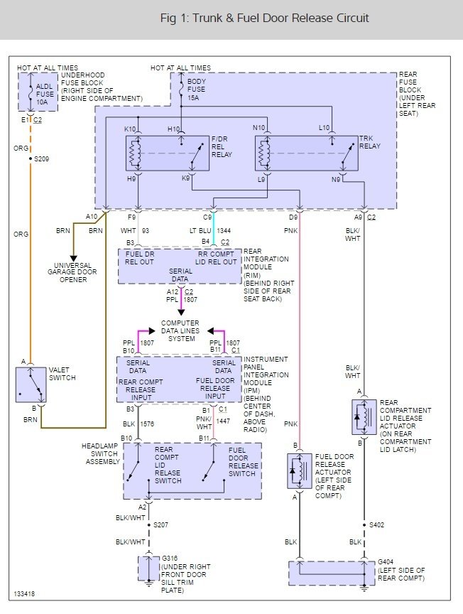

I have a 2000 Deville and cant open the trunk, gas door from the remote or the release button in the car whats the problem

There is a body fuse 15 amp that has blow, replace it and your problem will be fixed. Here is a wiring diagram so you can see for yourself and a guide to help you test the fuse.
Trunk release operates normal with remote. When ignition key is turned on, trunk release opens trunk and continues to click while trunk is open and ignition key is on. Trunk catch will not engage as long as ignition is on.

Try opening the trunk using the release switch and then disconnecting the switch from behind it. Most likely the switch is getting ready to fail completely.

Thanks for the information, but disabling the system forces me to use a key to open the trunk at any time. I prefer to pull the wire when I am driving the car for safety and then reconnecting when not driving, so that I can enter the trunk using my remote. There must be a better way to stop the ignition switch from sending the "open now signal."

If we can determine that disconnecting the switch (in the glove-box I presume) after energizing it does or does not stop the lock from being energized, we can determine whether or not the switch is faulty and requires replacement. If disconnecting the switch after using it to open the trunk causes the trunk lock to stop clicking, we can be reasonably certain it is causing your problem and that replacing it will fix the problem for you.

A very simple question. I have a 1996 Sedan DeVille. The electric gas door release and the electric trunk release both failed at the same time. I assume that they share a common fuse, but I cannot find anything labeled for these features in the fuse block under the hood. Which fuse is it?

Check the 20Amp fuse labled convenc in the trunk fuse box.

First, a very simple check to add, the valet switch in the glove box that will disable both these features if it is in the off position.

Check fuse under rear seat and relays. Also check fuse underhood

I have a 2005 Cadillac deville. The gas door and the trunk release, both stopped working on the dash and the keyless remote. I can only open the trunk with the key, and the gas door through the emergency release

Check the valet switch in the glove box.
