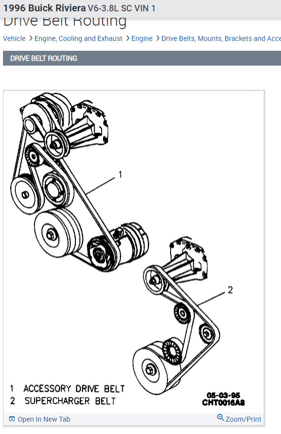

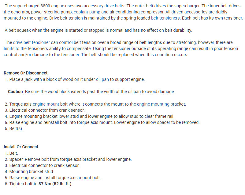

I need to replace the belts on my supercharged V-6 Buick Riviera. The factory shop manual details how to disconnect the engine mounts and lift/lower the engine, which I can do. However, when it comes to replacing the belts, it simply says remove and replace! Now, I realize there are tensioners used to maintain belt tension. My question is, how do I release the tension supplied by these tensioners? My "common sense" says to use a socket/breaker bar to move the tensioner in the proper direction, but unless the threads on the pully bolt are "backwards", I worry than I'll just loosen the pully, and nothing more. Please advise me on the proper way to do this.

In order to release the tension on the belt you will have to use a appropriate size socket with a bar and apply clockwise pressure, this will release the tension and will allow you to remove the belt.
To install the belt simply reverse the process.
