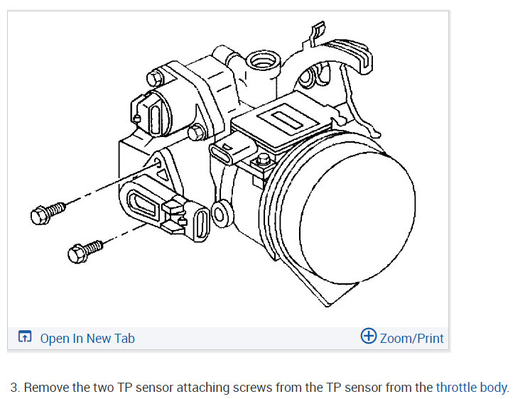

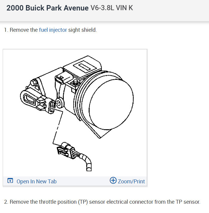

Here is the correct way to install the TPS, it self calibrates over a few miles of driving. This guide may help you with the high idle problem.
https://www.2carpros.com/articles/engine-idles-too-high
Check out the images (below). Let us know how it goes
