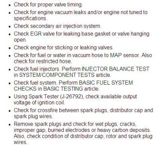

Wont start just backfire
Do you
have the same problem?
Sunday, January 10th, 2010 AT 2:19 PM
JDL
  • EXPERT
Welcome to the forum, maybe timing issue? How long since a tune-up? I'd still want to check for spark at the plugs and fuel pressure. When you check for symptoms without codes or anything to point you in the correct direction, the list is long, of possibilities. the list below is not complete.
