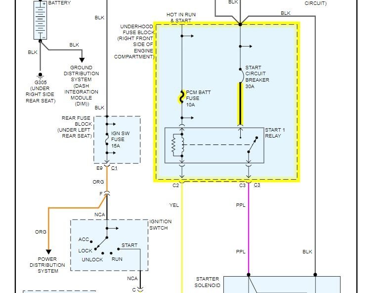

The car has been running fine. I just went out to start it to go to lunch & it won't turn over.
It acts like it wants to but it just won't.
Any ideas?
Please respond asap, thanks.

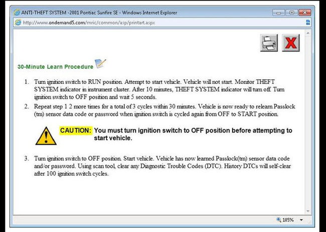

Verify cars security system is not failing. Turn key to the crank position then leave the key on. The security or theft light should come on and then go out. If it flashes steady then you have a problem. Let us know how you make out because if it is a theft problem we can walk you through a temporary repair.

The security light came on & then went out.
