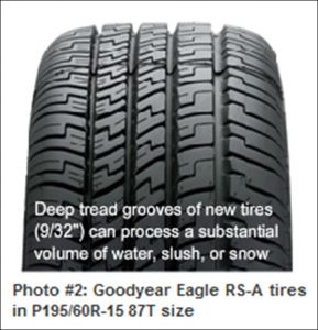

A typical passenger car tire has about twenty square inches of total footprint surface and begins with about 1/3" of tread depth. While the majority of the footprint surface is made up of the rubber that grips the road, the remainder is the void of the grooves that make up the tread design. (See Photo #2)
http://www.2carpros.com/forum/automotive_pictures/248015_Tire_1_1.jpg
http://www.2carpros.com/forum/automotive_pictures/248015_Tire_2_1.jpg
Photo #2: Goodyear Eagle RS-A tires in P195/60R-15 87T size
Obviously the tread will wear away over the life of the tire and the volume of its tread grooves will be reduced. While this occurs so slowly that it may not be noticed day-to-day, ultimately there will be a time when the driver will notice the car slip in the snow, hydroplane in the rain or simply not stop in as short a distance on wet roads.
In order to confirm how much wet traction worn tires sacrifice, members of the Tire Rack team measured the stopping distances from 70 mph (the typical speed limit of U.S. Interstate highways) with vehicles equipped with sets of new tires and compared them to tires with about 4/32" (3mm) of remaining tread depth, followed by sets with the legal minimum of 2/32" (1.6mm) depth. The differences surprised us! Vehicles equipped with the 2/32" minimum tire tread depth took about 100 more feet to stop and were still traveling at about 45 mph at the same distance the vehicles equipped with the 4/32" deep tires had already come to a complete stop!
The Tire Rack's advice is that if rain and wet roads are a concern, you should consider replacing your tires when they reach approximately 4/32" of remaining tread depth. Since water can't be compressed, you need enough tread depth to allow the rain to escape through the tire's grooves. If the water can't escape fast enough, your vehicle's tires will be forced to hydroplane (float) on top of the water, losing traction and increasing stopping distances.
Additionally, if snow-covered roads are a concern, you should consider replacing your tires when they reach approximately 6/32" of remaining tread depth to maintain good mobility. You need more tread depth in snow because your tires need to compress the snow in their grooves and release it as they roll. If there isn't sufficient tread depth, the "bites" of snow your tires can take on each revolution will be reduced to "nibbles," and your vehicle's traction and mobility will be sacrificed.
