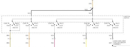

I couldn't start my car. So I figured my battery was dead because the lights were acting weird. I charged the battery that didn't help I tried a jump that didn't work. I charged it overnight and in the morning I turn the key and there is nothing at all complete darkness all across the dash. Please help if you can.

My first thought was to check feed to and from the ignition switch. The orange is voltage feed to the switch, hot all the time. The wire colors along bottom of switch in diagram, goes hot depending on the key position. You could track voltage from battery to fuse blocks? Use a voltage tester.
http://www.2carpros.com/forum/automotive_pictures/512072_lesabre_ignition_switch_feed_1.jpg
