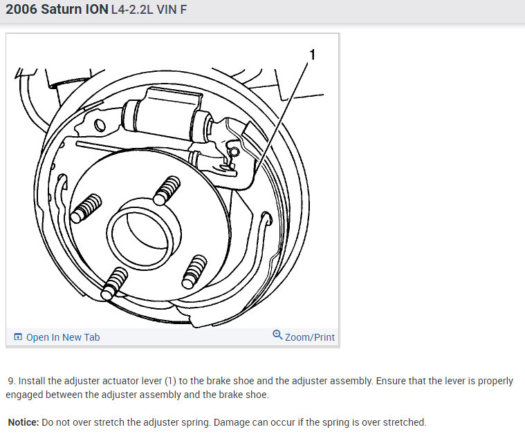

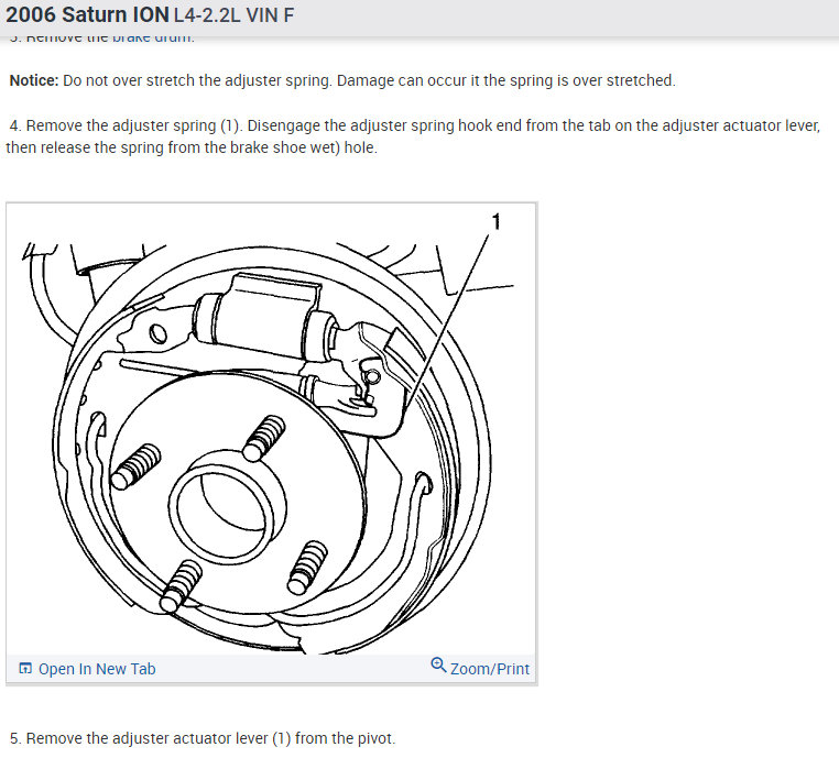

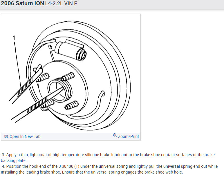

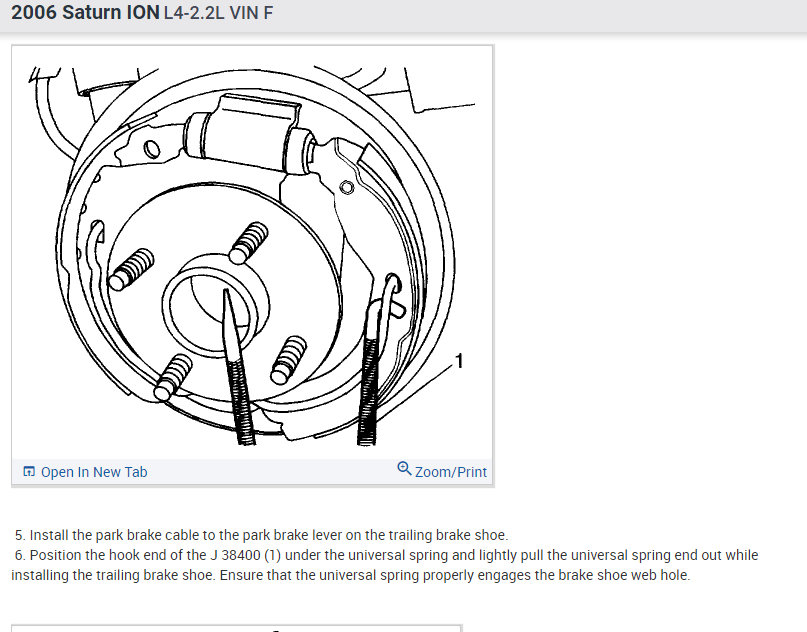

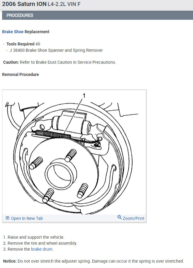

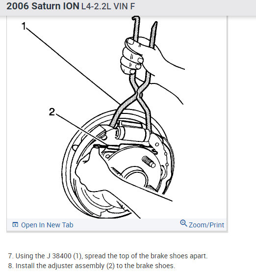

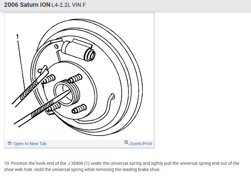

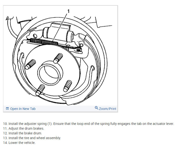

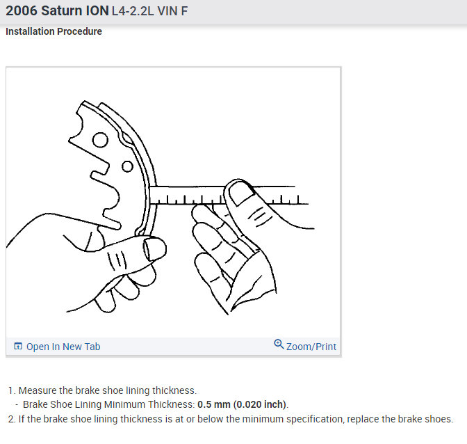

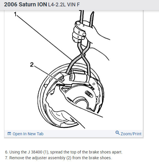

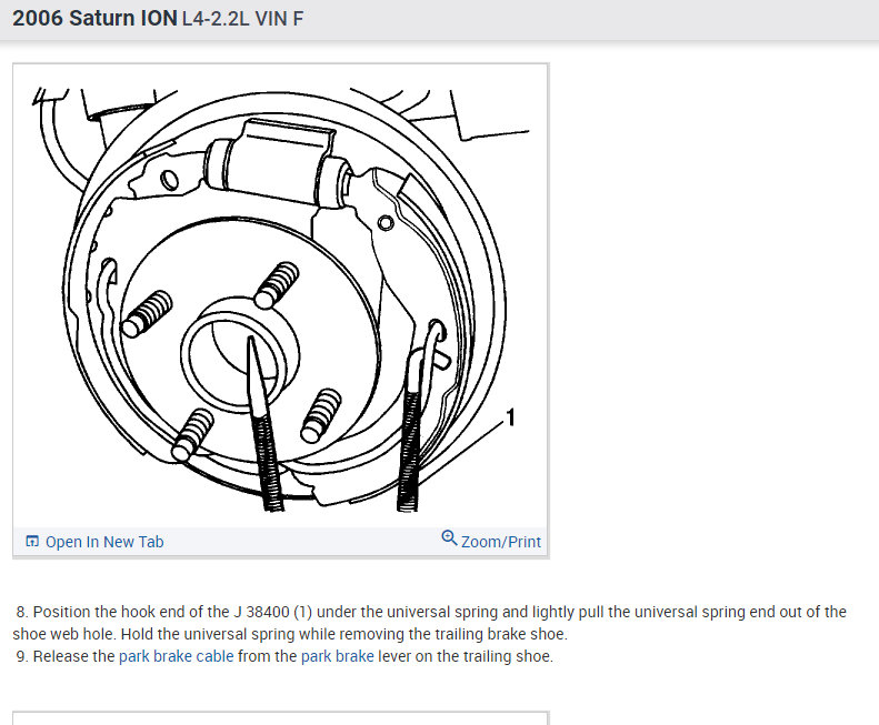

i am trying to replace the rear brake shoes and i need to know how to remove the emergency brake cable from the shoes and the part that hold the shoes on to the back plate. can you send me a video on it? it would help me out a lot.
Oct 10, 2016 at 2:16 PM
SQM
  • CAR REPAIR CONTRIBUTOR
  • 6,383 POSTS
In order to replace the rear shoes, you will have to use a special tool.
Which will allow you to remove the shoes from the parking brake adjuster.
Here is a helpful guide on how to change the rear shoes:
https://www.2carpros.com/articles/how-to-replace-rear-brake-shoes-and-drums
I have attached the replacement instructions below.
