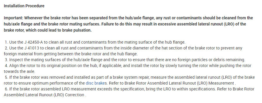

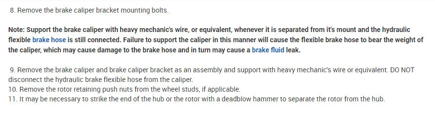

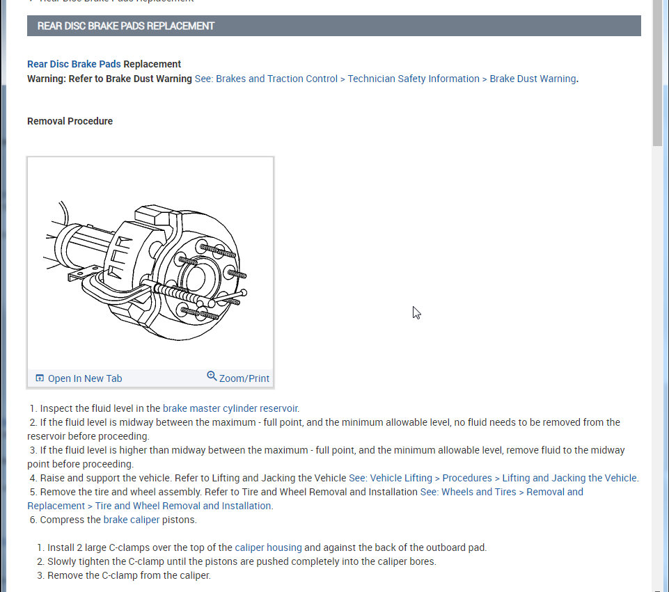

Has new calipers all around, new flexible lines up front, and a new master cylinder. Master cylinder was bench bled and then bled the lines from rear passenger to which fixed it but I noticed I need rear brakes
Nov 11, 2020 at 7:57 PM
  • CAR REPAIR CONTRIBUTOR
Here is a guide that will help with this:
https://youtu.be/PAjUx1Rct4Q
and
https://www.2carpros.com/articles/how-to-replace-rear-brake-pads-and-rotors
Plus below is the process from the manual that will help with this.
Please run through this material and let me know what questions you have. Thanks

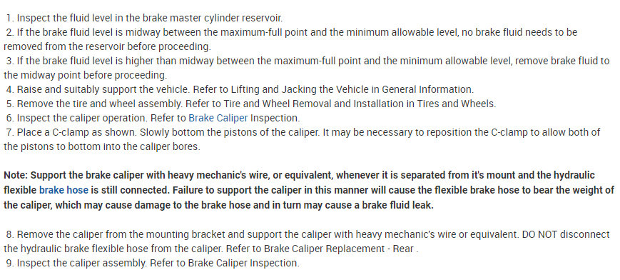

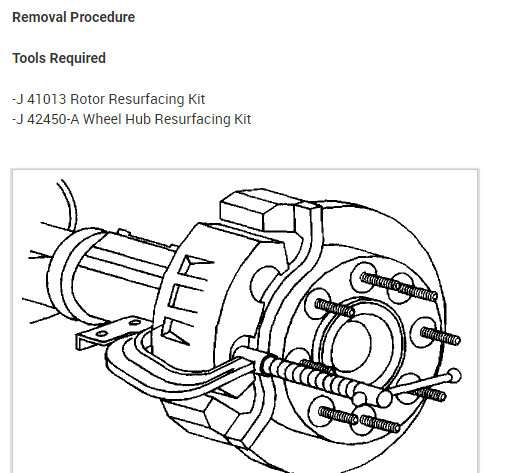

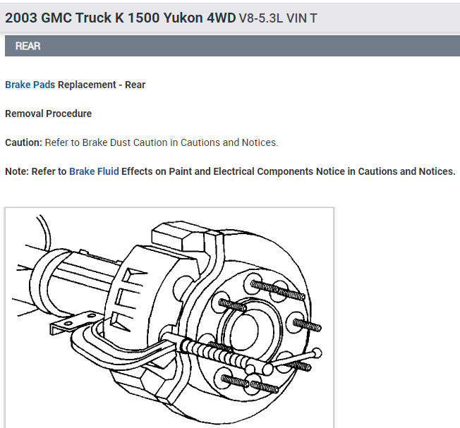

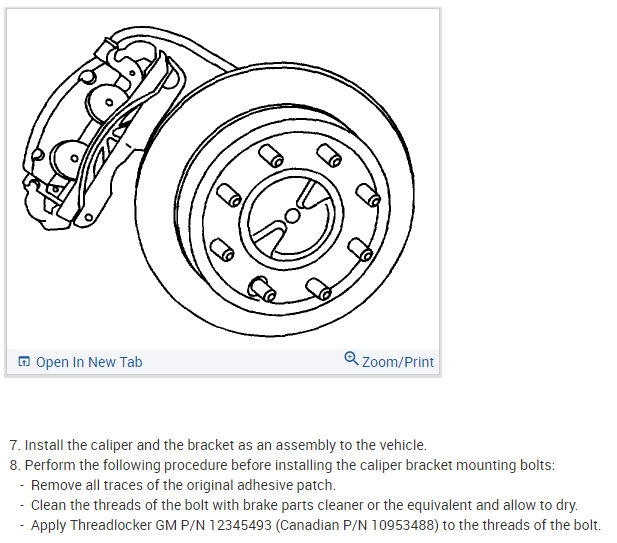

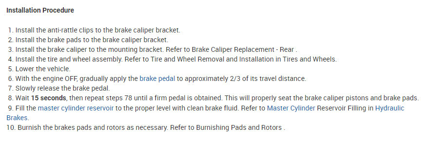

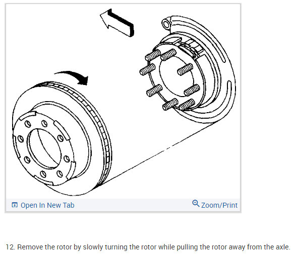

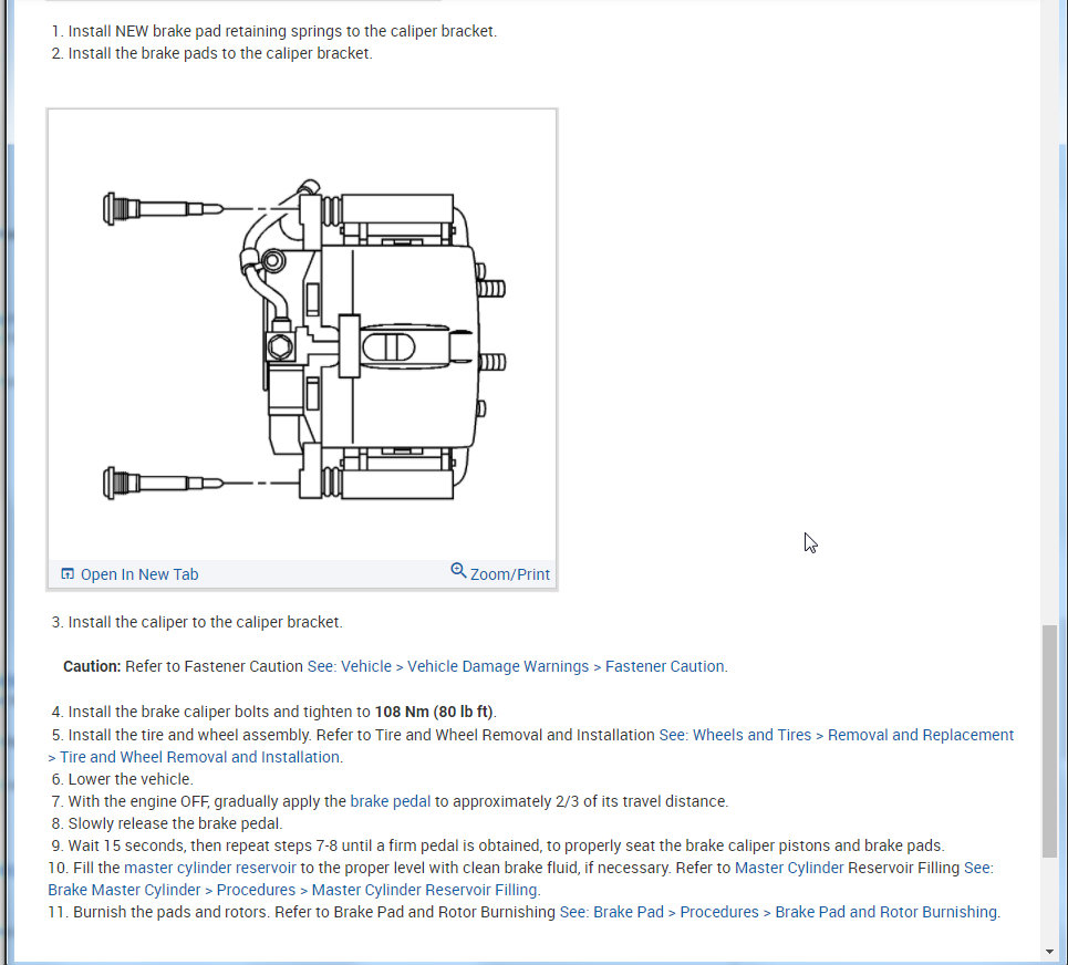

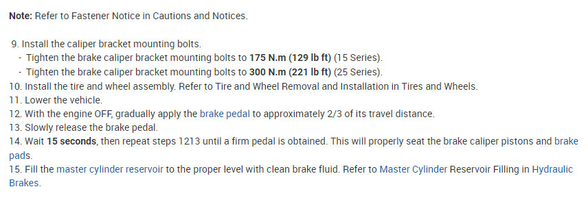

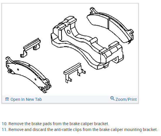

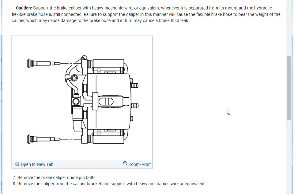

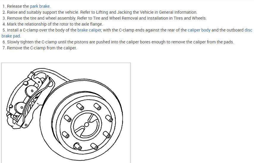

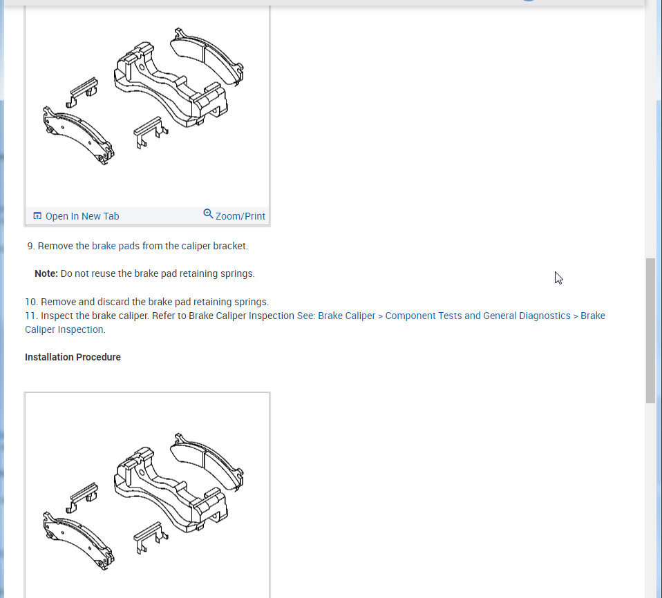

Here is the information you requested. Here is a tutorial on how to remove and replace rear brake pads and rotors:
Here is a YouTube video from our site on how to compress the rear caliper piston when performing a rear brake job:
https://youtu.be/j8YwfSKEzZo
I've attached picture steps below on how to replace the brake pads on your truck. Hope this helps and thanks for using 2CarPros.
