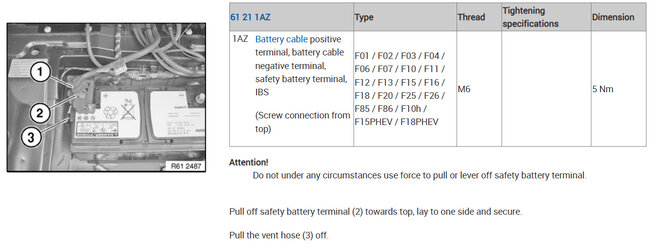

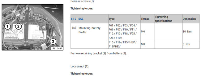

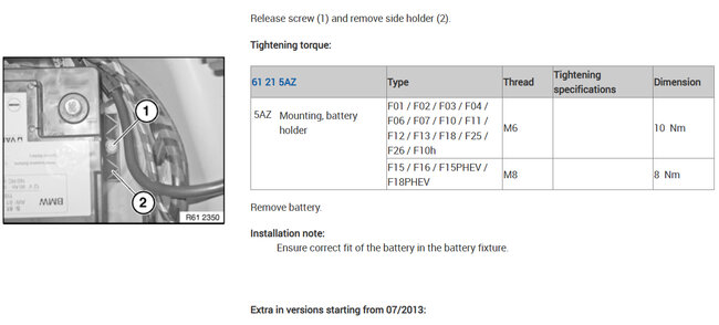

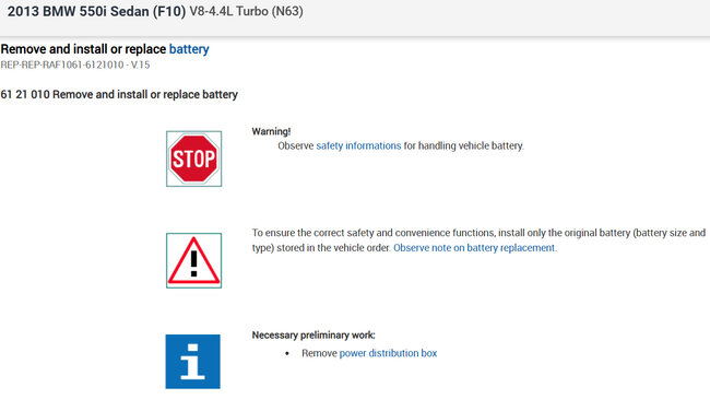

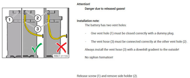

The "rattling" is the concern which can cause all of these codes but the low battery voltage. If the battery is bad, it may even have an effect on the engine misfire, glow plug and camshaft codes. I would upload a short video of the engine noise from under the hood so I can hear what the problem is, and I would remove the battery and have it tested at the local auto parts store. Here is how to remove the battery and its location which is in the trunk. Be sure to clear the codes if they find the battery needs replacement. Check out the images (below). Please let us know what happens.

Hello Ken,
Thanks for replying. I replaced the battery which definitely helped. Thanks for that tip. The car is still rattling which I've uploaded some videos of the engine and exhaust.
