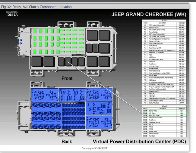

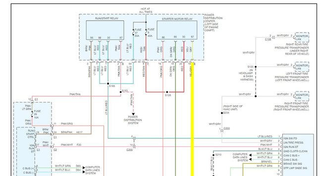

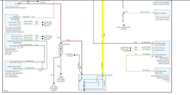

Hi again:
It could be a few things. Check the main fuses in the power distribution box under the hood. Fuse 7 is for the starter solenoid. Here is a link that shows how to check fuses and for power at the fuse:
Next, confirm the starter relay is good. It is in the power distribution box also. It should indicate on the lid of the PDB which is the starter relay. I attached a picture of the section of the box you are looking for. Also, you have two choices. Switch the starter relay with a different one from the box that has the same part number, or you can test the relay itself. Here are directions for testing:
Now, if everything checks good with those things, then the starter should be tested. Here are directions explaining how to check the starter. It will have you test for power at the smaller wire on the starter solenoid. The large (heavy gauge from battery) is hot all the time. The smaller only gets power when the key is in the start position. If it does get power and the main supply (heaver wire) has battery voltage, then the starter is bad. Here is the link:
To be honest, I have a feeling it is either the relay or the starter itself. More than likely, the starter, but you need to confirm that via these tests.
Please feel free to let me know if you have other questions or need help.

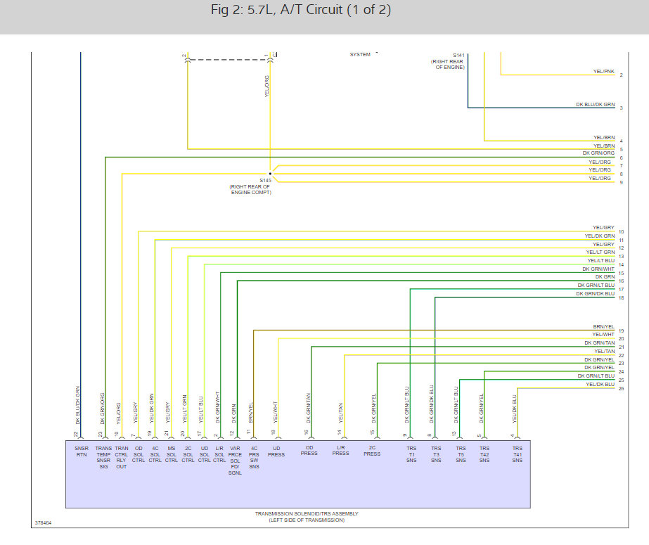

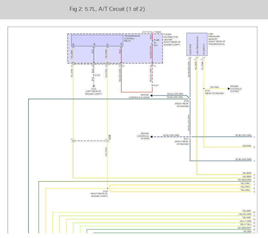

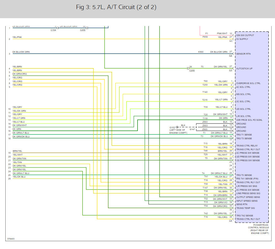

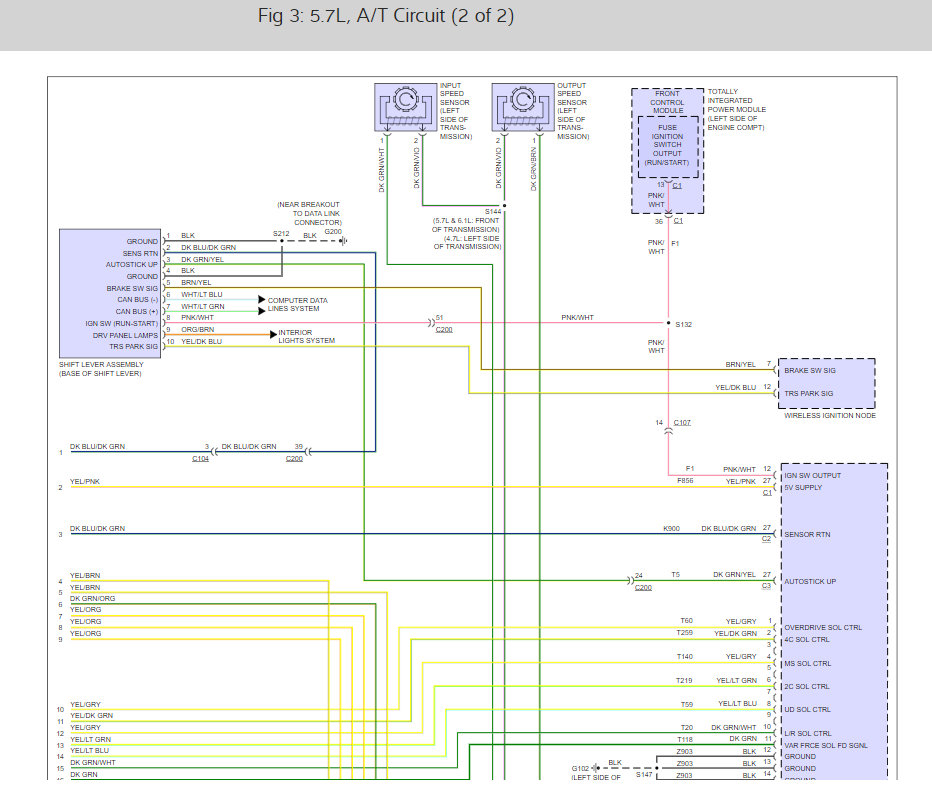

TRIGGMAN
I did some front end work that required me to unplug the two fuse boxes and remove the battery. When I put everything back together the vehicle will not start and it will still roll freely when in park.
Aug 31, 2020 at 12:32 PM (Merged)
  • CAR REPAIR CONTRIBUTOR
  • 54,334 POSTS
Let start by checking for power at fuse #22, but it sounds like one of the connectors is not all the way together. Can you please recheck it here are the transmission wiring diagrams so you can see how the system works?
This guide can help as well:
and the transmission control relay.
Check out the wiring and fuse panel diagrams (below). Please let us know what you find. We are interested to see what it is.
TRIGGMAN
It ended up being a wire going to the starter. The Park issue was the transfer case was in neutral. Do not know how that happened.

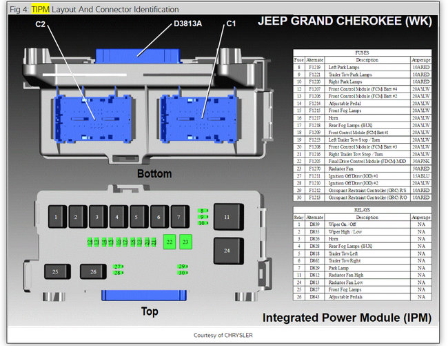

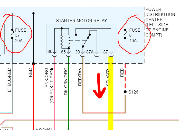

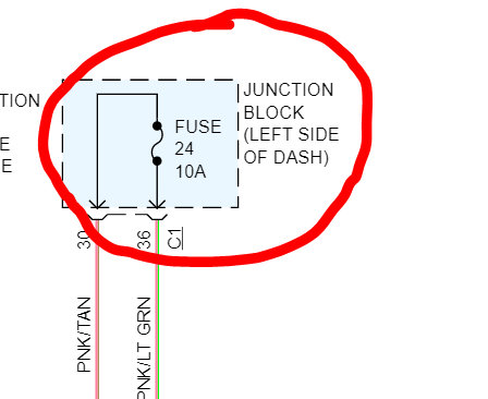

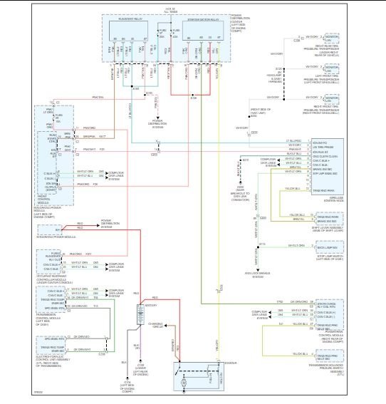

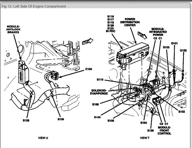

TANZIISH
While trying to replace a stereo in my car, I accidentally touched two wires coming from the plug together and ever since then my car won’t start. I’ve replaced the starter (for some reason it failed the test so I thought that was the problem) and tested the battery, which is good. I can’t seem to figure out the issue. I’ve also checked all fuses and none are blown.
Aug 31, 2020 at 12:33 PM (Merged)
  • 110,190 POSTS
I need you to check 3 fuses for me. I attached two pics below and am not sure how they would have blown, but I'm not sure which wires touched. Check these and let me know what you find. In the first pic, the arrow shows which wire is going to the starter solenoid (S Terminal). It should only have power when the key is in the start position. If you have a helper, see if there is power to that wire at the starter when the key is in the start position.
Let me know what you find.
Here are a few links you may or may not need. Just adding them in case.
Let me know if this helps and what you find.
