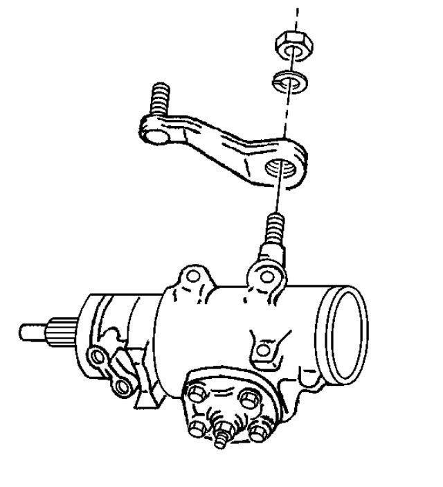

Any tips on taking off the Pittman arm on the front driver side

Cannot find any videos on instructions for this vehicle. Cannot even get the nuts off and it is such a tight fit even if i did i would not be able to take of the arm out. Any one know any good videos on this truck's Pittman arm dissemble? I have had no luck finding any information on it online. :(

if you are going to reuse the Pittman arm then the box has to come off put in a vise then a puller must be used to pull it off which is no easy task removing them. if you are not going to reuse it , use a cut off wheel cut it then split it it will fall off practically.

Yea no kidding though so many miles i took the nuts off, but man it is so stuck on there it is taking some in saneness to take them loose. I am making progress though. thanks for the advice. I will try this next.

Hey Will,
Here is a video that shows the job being done that we did in the shop.
https://youtu.be/KKeFqHLuRQ0
Please let us know what happens so it will help others
Best, Ken

if you live in a northern area pitman arms were always are difficult to get off due to salt and other crap making it very very hard to get off. I have personally broken pullers trying to remove them
