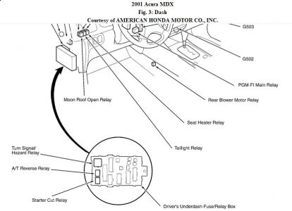

2001 Acura MDX 6 cyl Four Wheel Drive Automatic 110k miles
how do I change the emergency flasher relay?

Hi 1bman1, The flasher is plugged into the dash relaybox and to remove it, you need to use a rocking motion to release the 2 clips at the side to get it loose. It sometimes is rather tight and might need some force to get it off. Alternatively you can use a sharp pointed object to pry the locks slightly to release it. Space ia rather limited so second option is not easy to implement.
https://images.2carpros.com/forum/automotive_pictures/192750_DashRelays01MDX_1.jpg
